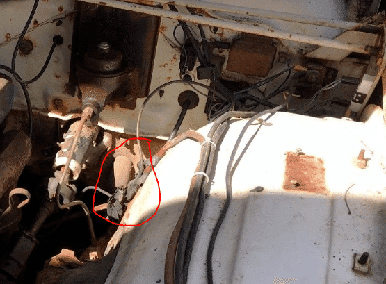

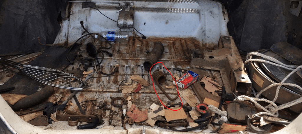

I noticed something in the trunk picture. I thought 'what is that doing in the trunk of this car?'
Then I looked at the other pics again and saw signs underhood, underneath, and in the interior that explained it.
Maybe it was avaialble, but it doesn't fit the style of the 300, and I don't remember ever seeing one equipped this way.
6 cylinder distributer cap? Nevermind. looking again it's probably for a V8.
I'm thinking you and Stan have the knowledge to figure this one out. Look at the junk in the trunk, and see if something springs out at you.

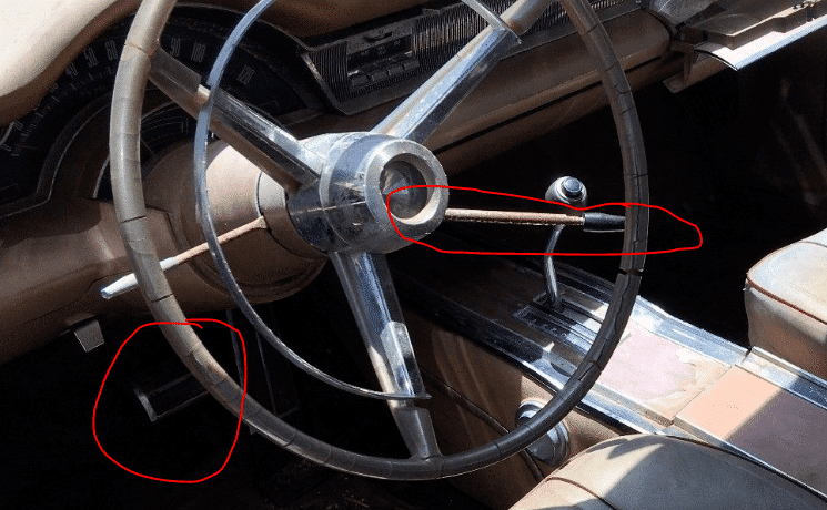

It was a 3 on the tree. Assuming the P/S wasn't added, it's a one option car. The console is not original. There was a three on the tree 4 door '66 300 in a junkyard near me about 15 years ago.

I saw the big spring, the overcenter spring for a clutch pedal.
Then I saw the short pedal, thought 'huh, somebody converted a 4-sp to a console AT.
Then in 1 other pic I saw the column-shifter-handle hanging down.
A 3-on-the-tree 300, with radio delete, manual brakes. Due to being a 300 of the 65-66 era, I believe it would be the unusual 383-4 barrel with single exh, rated at 315hp.
