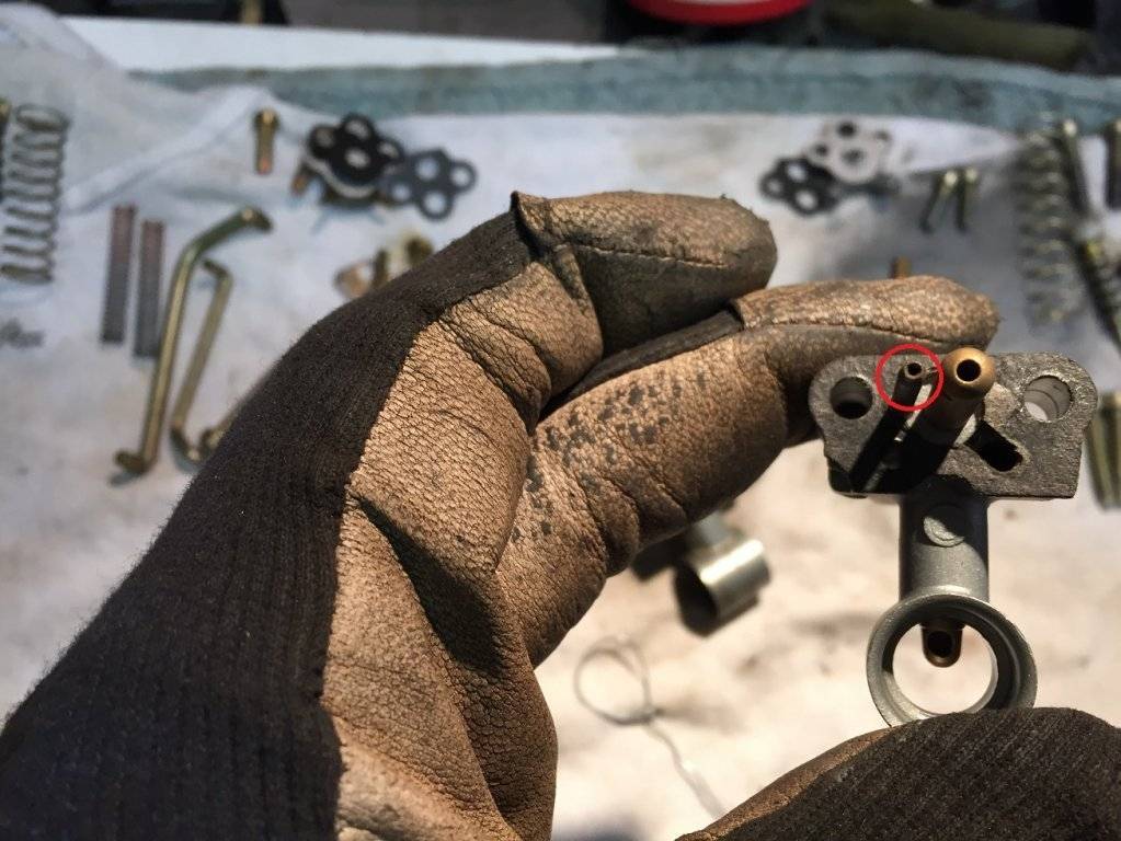

Sometimes the the idle jets (idle tubes) on the 1406 are a bit small for the application and you get off idle stumble, I guess it's the same situation on the 1411, unfortunately there's no changeable idle jets so you have to drill them out a tiny step carefully by hand (hand chuck).
You find the idle tube on the 1st cluster:
What size do you drill them out to?

I tried everything on my 1411 jets,springs,metering rods as well and the off idle stumble drove me nuts.
But I did cure it by going with a eddy nozzle kit.
I put in the biggest nozzle the kit had which I think were the .043 and problem fixed.
