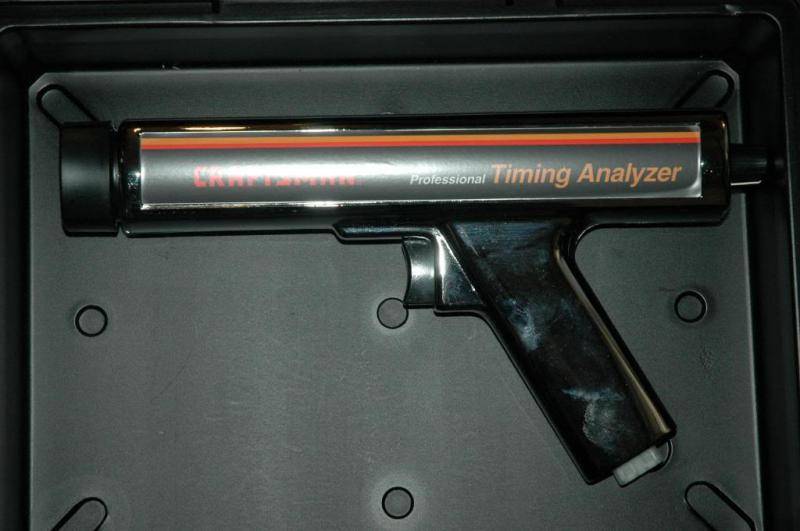

I have a Craftsman Timing Analyzer that I've had for at least 20 years and works great. Adjustable from 0 to 65 degrees.
