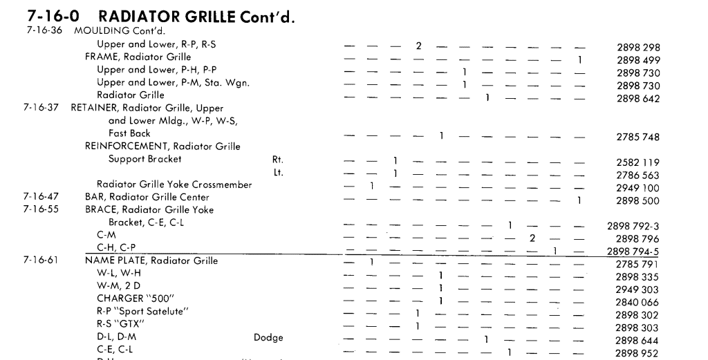

Part number is 2898 952
Grilles and their parts are typically listed in Group 7 - Cooling... so I looked there.
Thanks,

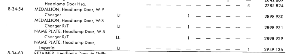

I saw that one but noticed that the headlight door is list in electrical and the only emblem listed in that section was for Chargers. So I just wanted to make sure that I'm looking at the right part number emblem.
I think so, since the parts book shows it to cover all Chrysler grilles, presumably regardless of placement - Newp, NYr and 300, even though in the Group 8 Ele tical image you posted (with the explosion drawing of the headlight doors), you can clearly see the word Chrysler on the headlight door and Imperial in the other drawing which is the expansion image of the headlight door assembly.
As you noted, your image of the parts list clearly shows there's no listing for anything but Dodge and Imperial in the Group 8 headlight door nameplate section, Chrysler, including Newport, New Yorker and 300 shows up in group 7, presumably because of the emblem goes in different locations on the grille as per model.

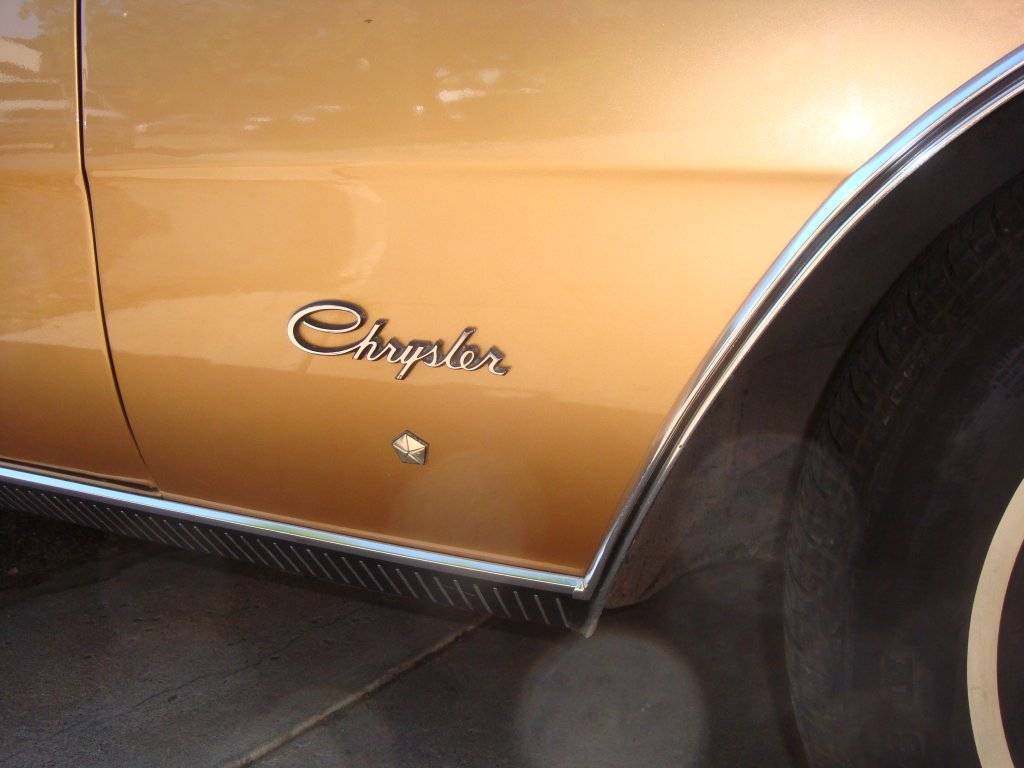

Does anyone have a 1970 Chrysler 300 Convertible fender emblem? I need to verify the part number and pin configuration on the backside of the emblem
I thought I might have one, but nothing here. They were missing from my 300 vert.
@Samplingman has a lot of convertible parts and he may have one.
Honestly, up to a couple minutes ago, I didn't know that was a convertible only piece, although IIRC, that same emblem was used on other applications. Possibly a superseded part number comes into play.
Without looking at my parts catalogue, is it not the same as what was on the C pillar of sedans and hardtops?
The parts catalog list 3444196 for the c pillar on hardtop/sedan and 3444181 for the convertible fender. I suspect that the 3444181 is not a good number as no one has that emblem. I ran into the three hundred emblems the parts book listed 3444169 and the emblem off a 1970 car had 2964807 on the actual emblem. That is what I suspect that we will find on the Chrysler script emblem.

Yes it is weird. I ran into this same scenario on 1971 charger headlight door emblem and it ended up being used on multiple Dodge cars

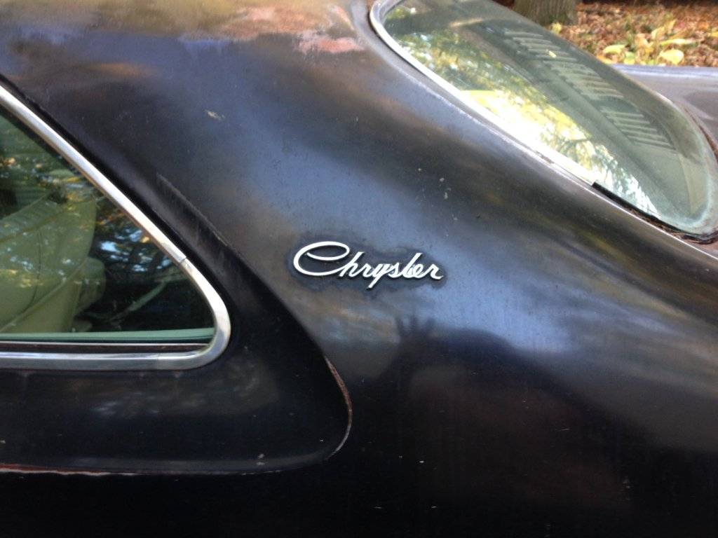

I have a set (I think), but I’m still 4,000 miles away. I’ll be sure to look when I get back, but I too thought they were the same as the C pillar on the coupe, which I know I have. I actually thought at one point that they were stick-on, not sure where I heard that or if that was even a thing. None of my fenders have had holes for pins, so I might have assumed.
Coupe:
Vert:

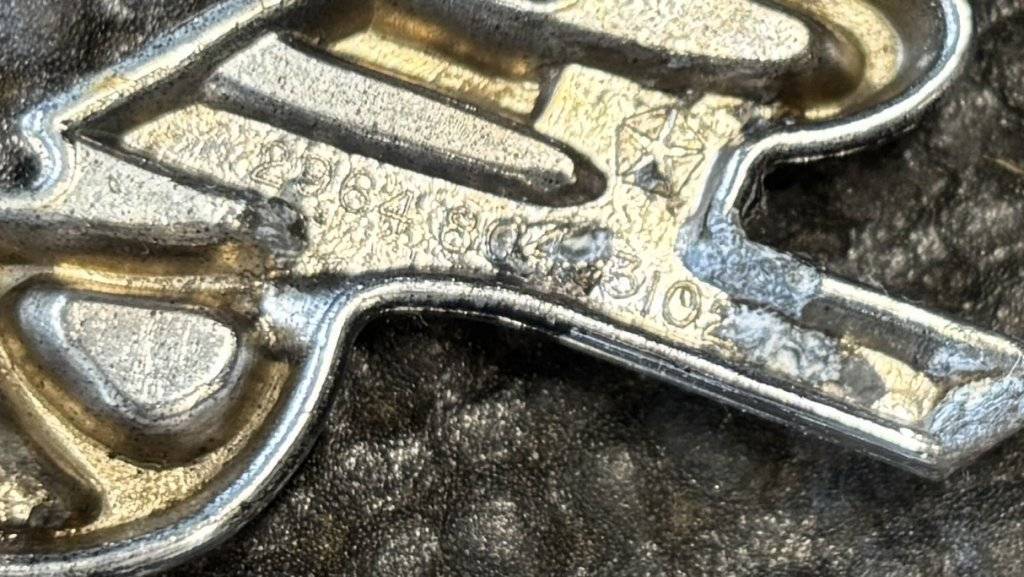

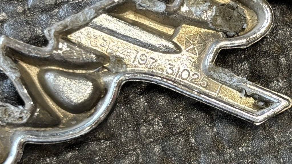

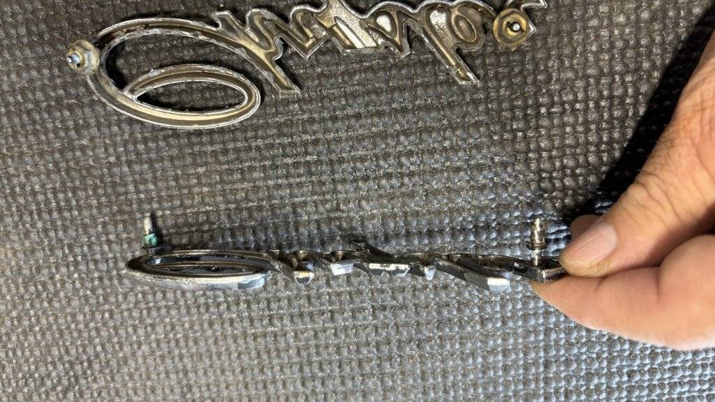

So this is what I have, one from a convertible, and left and right from a coupe. The posts all are in the same position, but the convertible emblem uses barrel clips while the coupe has speed nuts. The fenders I have are not from a convertible so I cannot confirm the actual post positions.
Convertible side unknown 2964 804 3102? ?
Coupe left side 3444 197 31025 1
Coupe right side, 3444 196 31025 2
All of these look identical in shape and size. Hope that helps.

Thank you! this clarifies a lot. it seams that the 2964804 emblem follows the pattern that the parts book numbers were superseded as I have found all of the 3444 numbers are actually 2964 emblems on the cars. Those sail panel emblems look like they have the same pin configuration as the fender emblem, that is very interesting as well. I have noticed that Chrysler makes a left and right side emblem but they are identical in most cases. I'm not sure why they did that, the 68-70 charger sail panel emblem was the same way but they are completely identical other than the last digit of the part number.

No problem, glad to help. I would still like to see a convertible fender with the hole pattern to be 100% sure that they are the same. None of my fenders have been from convertibles so I can't check. The barrel clips make sense for the fender emblems, but could also be the reason for the superseded P/N when they changed to speed nuts. Just throwing that out there, better safe than sorry.
