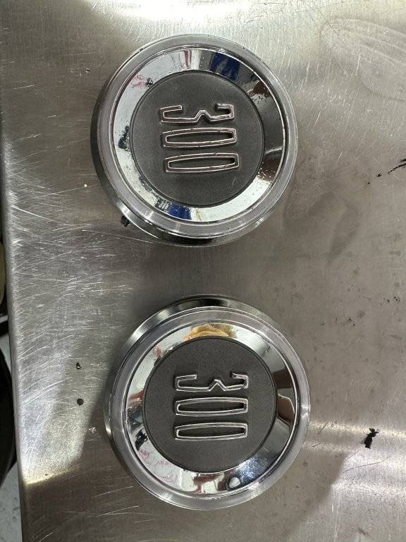

can someone help me out with how to reattach my emblems to the doors?? They broke coming off. Thanks!!

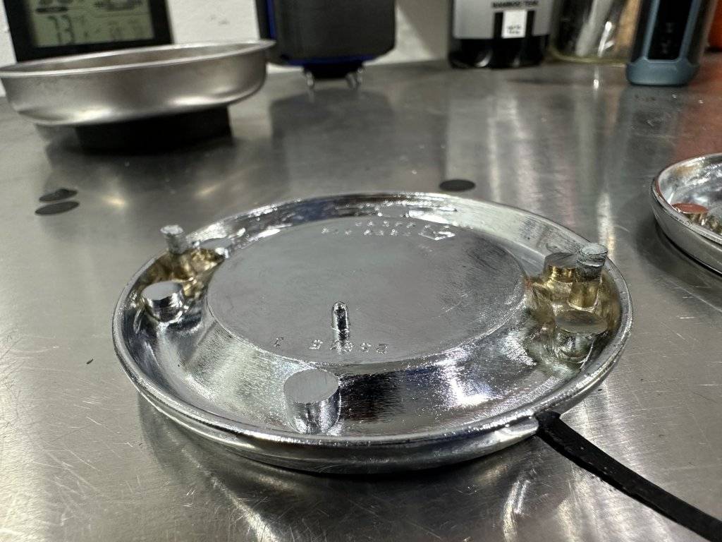

There’s no way to be able to pull them into the padding? I think I read somewhere that someone epoxied small screws to the broken pieces, but not sure

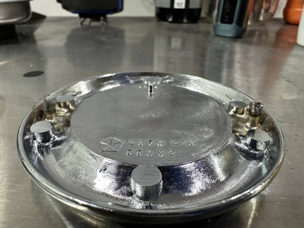

It does look like there are 4 opportunities on each to drill and tap with a bottoming tap.
So, four round pads to limit compression of the mounting surface, one locating dowel, and TWO extensions which would index with holes in the pad, which would then be melted to secure the trim pieces to the inner side of the panel. I suspect the 3M double-sided tape might work better, but in a roll in the u-shaped areas rather than on the flat areas.
Alternative would be to use some very small screws, drill small holes in the two "heat/melt" towers, then put some thin sheet metal for the screw to screw through, and carefully attach them from the backside of the panel. Being careful to only SNUG the screws.
