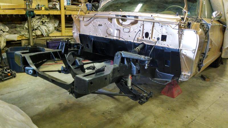

I detailed the underhood on Jazebelle without removing the engine, heater case, brake booster and wiper motor. Used a small compressor and a cheap jamb gun to apply the color to the firewall, core support, engine, (hirsch paint), and frame & suspension.
The wheel tubs were removed, stripped and painted satin, (semi gloss), black. I then sprayed the outter surface wth a rubberized undercoating from spray cans.
I did this before painting the exterior of the car so you'll need to do some serious masking to protect your exterior.

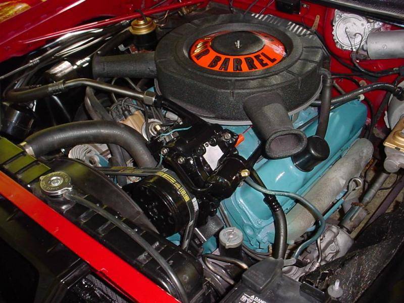

It's R6, Crimson red. The original color of the car.
Plymouths called it bright red and on a Dodge it was Scorch red. All R6 code and all the same color though.
thanks thought so but I'm don't recall the year of your car. Mine is PP1 68 and I'll be painting the engine turquoise too of course.

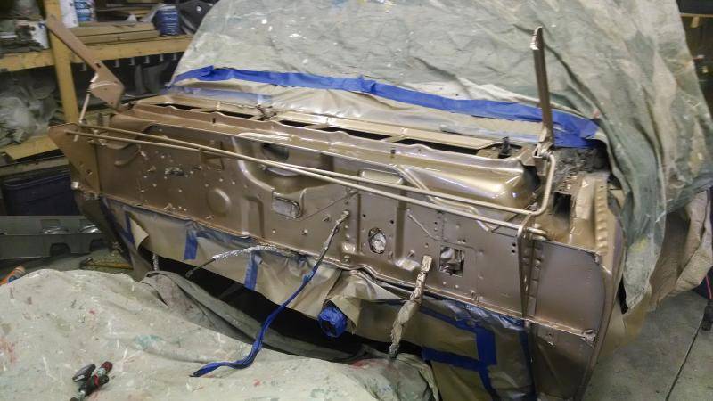

I will go back after lunch and pull tape but the firewall is painted cleared.:yaayy:
