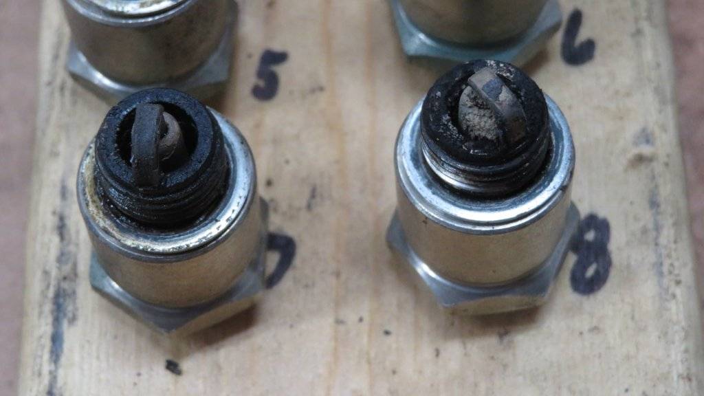

The backstory: Engine rebuilt on the 'Party Barge' - 1965 Newport 383-2v. Rings were Hastings 2M683.030 Moly (iron). Initial oil was Valvoline Racing Oil (10w30). Oil/Filter replaced after about 1/2 hour run time. (various throttle positions). Refilled with Schaffers 10w30 Racing Oil with zinc. Driven about 1000 miles, no issues. Average drive times 20 to 40 minutes, all local driving top speed 60 mph. Car is loaded up for a road trip to Carlisle. Driven for 6 hours at 70-75 mph. Used 2 quart to get there, approx. 500 miles. Return trip used about 1 1/2 qt.
Compression test shows 6 cylinders at 150, 1 cylinder at 143 and one cylinder at 155. Leak down test indicates that all leak down is past the rings (hose on dip-stick tube. No evidence of smoke at the tail pipe (had a friend following me to Carlisle). Tail pipe is sooty but not greasy. Re-builder says the ring did not seat properly, will need to be de-glazed and re-rung.
I have never had a engine with standard rings not seat. I will drive it for the rest of the season then decide what to do.

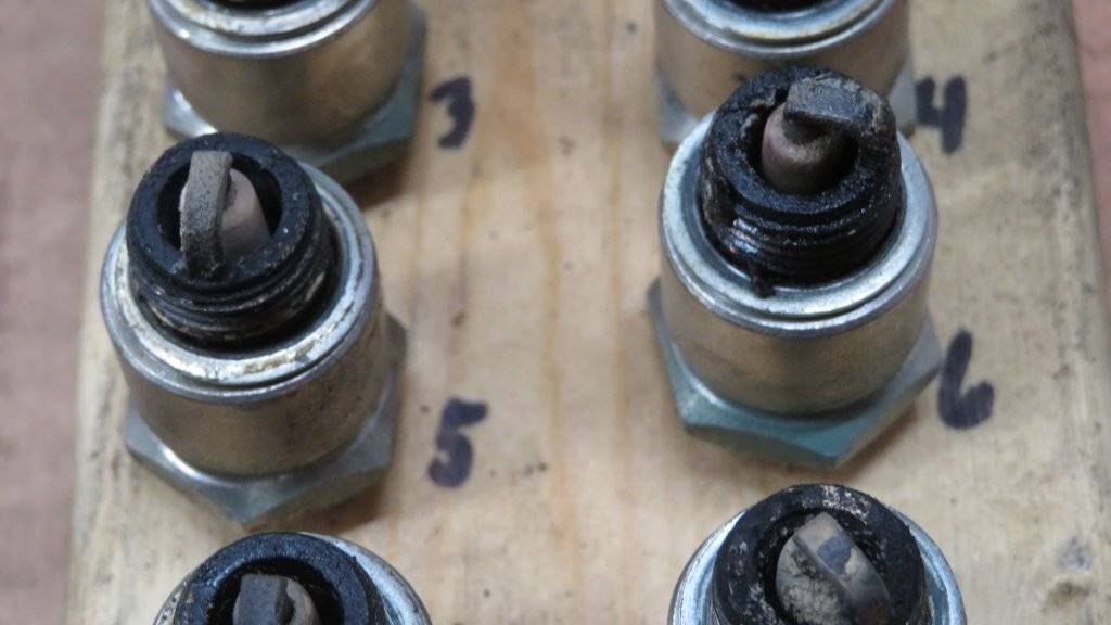

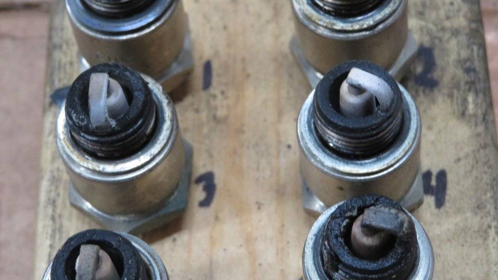

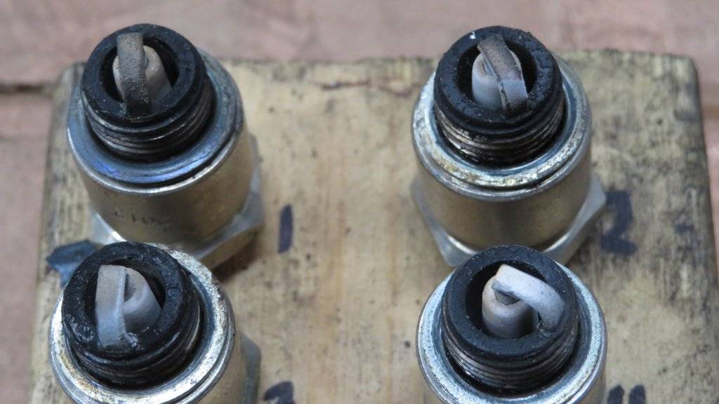

EDIT: I neglected to include pictures of the spark plugs. I changed them when I got back from PA. Also changed oil/filter (4qt Schaffer 10W30 and a qt of Lucas oil conditioner.
Any thoughts appreciated.

Leak down and compression tests ONLY test ring seal on the compression ring, whereas oil consumption is related to how well the oil rings scrape the cyl wall with each up and down cycle of the piston.
Sometimes we have gotten spoiler by modern motors which can run 10k miles and the oil level NOT drop on the dipstick. But back then, 3000 miles/quart was pretty good, as I recall. Many Chevies used more than that, as I recall.
You might put some more highway miles on it and see how things progress over about 5k miles. My late machine shop operative noted once that "moly rings" like a smoooth cylinder wall surface to work with, so he would put them in with the cyl walls un-honed . . . and everything worked as designed. In the one case I know if, it was an engine he built and the owner wanted to re-ring it (454 Chevy in a car hauler). No need for a full rebuild, just new rings. I asked the owner how it worked out, a few weeks later, to which he replied "Great".

Drive and enjoy the car, while also keeping an eye on the engine oil level. Look at the spark plugs to see their color and such, too. It might not get to the 3000 miles/quart level, but as long as it is more than 500 miles/qt, some quality dino motor oil will work fine. Just find the least expensive place to buy your choice of motor oil.

Since my last post, I thought about another potential issue: What kind of rings are you using - iron, chrome or moly? I know chrome rings take forever to seal and iron rings break in and seal pretty fast. Not sure about moly rings, but I think they seal better than chrome.
You have oil problems on 4,6,&8. How long before you switched to synthetic oil?
Me personally, I would switch back to regular oil (with zinc) and run it hard, like you stole it. May have broken a ring upon installation, I have a 305 chebbie that made plugs look like that in a few hundred miles. After I pulled it and it sat for a while I re-ringed it and put it in a van, it was a excellent engine second time around.
Sorry only 6&8 seem to have a problem, I thought 4 because of the picture stack in the post.
