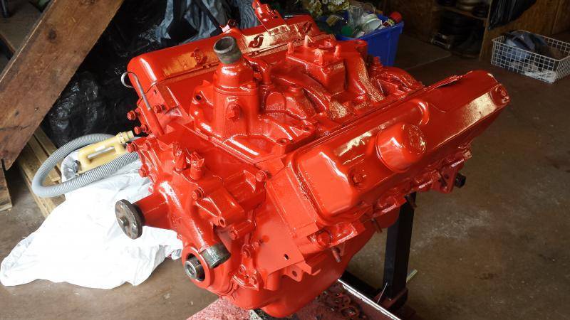

I repainted my 318 poly the factory colour which closely resembles orange but is the Chrysler Red for that year of engine.
