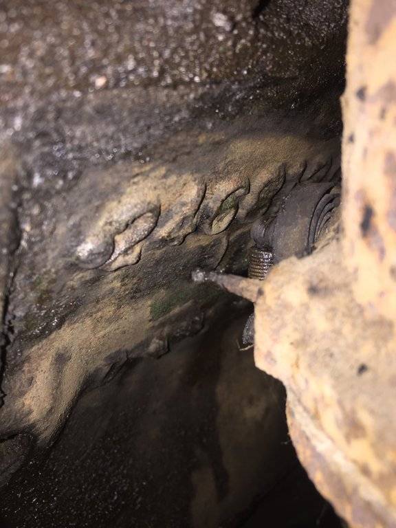

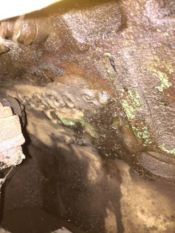

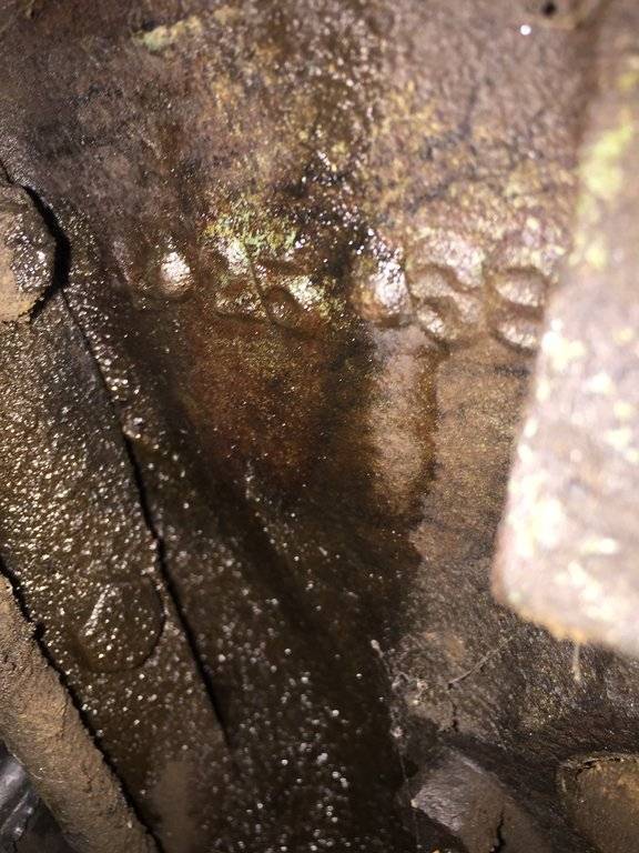

Been searching web and forums Trying to ID a mopar engine. Ive read to look in front of intake, below distributor, right side of bLock, left sidebof block. I was told casting would begin with "383" if it was a 383 which i belive it to be but i cant find anything beginning with "383" These are the castings i found on side of block: that which appears to be "4-25-68 was on the Drivers side. The other numbers behind manifold, were the same on both sides and were "2468130.8"

I get a 383
Mopar Engine Casting Numbers
The series and machine dates should be STAMPED into a pad just below the distributor. These letters/numbers are stamped, not cast. If the block was cast on 4-25-68 then the stamped date will be later then that. 68 was a "D" series, so will be "D 383", or "D 38". If the pad is blank then it is a replacement block.
Ive read to look in front of intake, below distributor, right side of bLock, left sidebof block. Look on the passenger's side by distributor. You should find D 383 and a date something like 5 12 2. You may find a Maltese cross, a letter A or possibly the letters HP. If you find HP, look at the rear of the block near the oil sending unit for a VIN number stamped on where the bell housing meets the block.
I was told casting would begin with "383" if it was a 383 which i belive it to be but i cant find anything beginning with "383". That information is incorrect. You have the correct casting number for a 383.

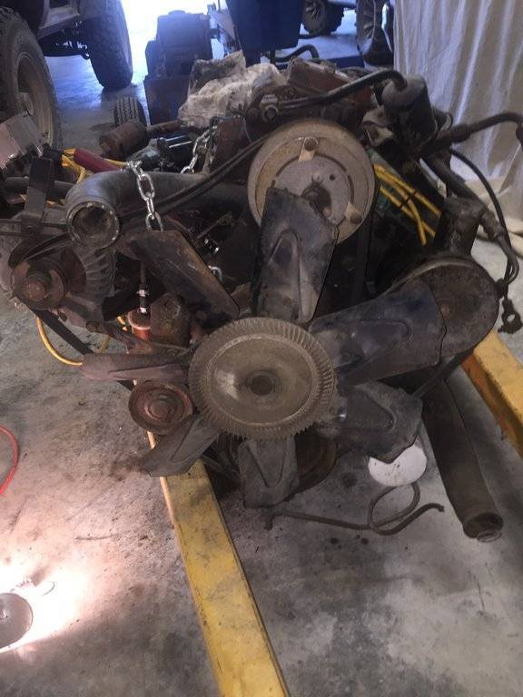

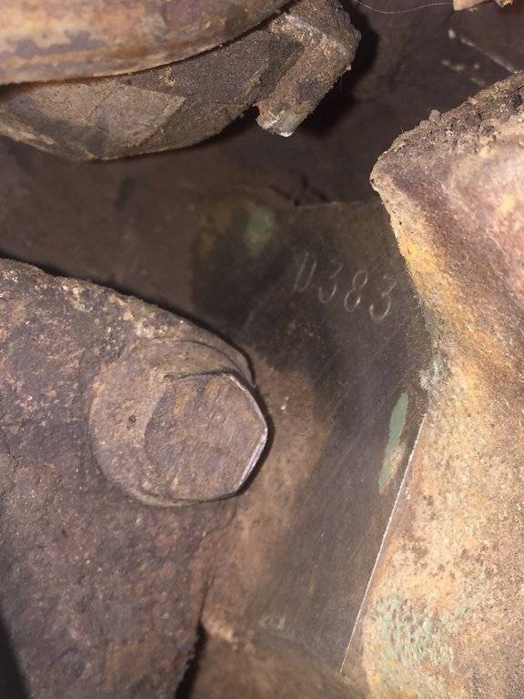

This is all i could find. Unless there's something behind that alternator bracket but I think that's unlikely.but I need to pull it anyway as I am going to do away with the AC. I will also attach a pic of the front of engine
I bet you'll find more once the bracket is removed.
