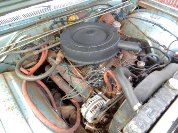

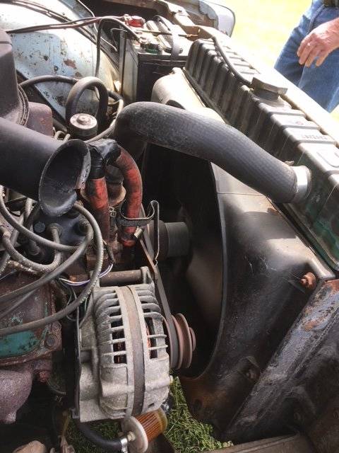

Ok I had some time today to work on my 66 300. With the vacuum Advance hooked up it stumbles & shakes badly when I begin to give it throttle. Diconect the Advance & it is smooth but accelerates very slow. I put a vacuum tester on it & removed the dizzy cap. It starts to move the Advance plate at 12 inches & stops moving at 17. Didn’t notice anything unusual about the movement. Everything looks surprisingly clean. Engine is a 383 low deck. Believe to be original. It still has points. The carb is a Edelbrock. The port at the carb pulls no vacuum at idle. I forgot to check at throttle. The other port has about 20 inches at idle. So I’m sure I’m using the correct port.

View attachment 235623 View attachment 235624 Ok I had some time today to work on my 66 300. With the vacuum Advance hooked up it stumbles & shakes badly when I begin to give it throttle. Diconect the Advance & it is smooth but accelerates very slow. I put a vacuum tester on it & removed the dizzy cap. It starts to move the Advance plate at 12 inches & stops moving at 17. Didn’t notice anything unusual about the movement. Everything looks surprisingly clean. Engine is a 383 low deck. Believe to be original. It still has points. The carb is a Edelbrock. The port at the carb pulls no vacuum at idle. I forgot to check at throttle. The other port has about 20 inches at idle. So I’m sure I’m using the correct port.

Have not checked plugs or wires. Today was the first time I have touched the car in a while. Was hoping to drive it some this winter so I’m trying to get it ready. Heater hose is fine. That’s an old pic.
Oh good... I thought this was a test to see who spotted the disconnected plug wire... or is that one really looped around the suspension to get where it belongs?
