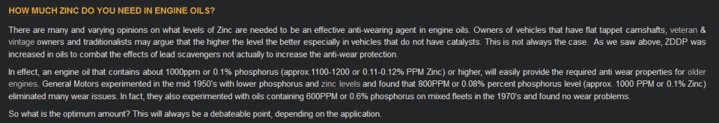

Regarding ZDDP...found this interesting article. From there:
I think the forum compressed the image so the text looks fuzzy...
