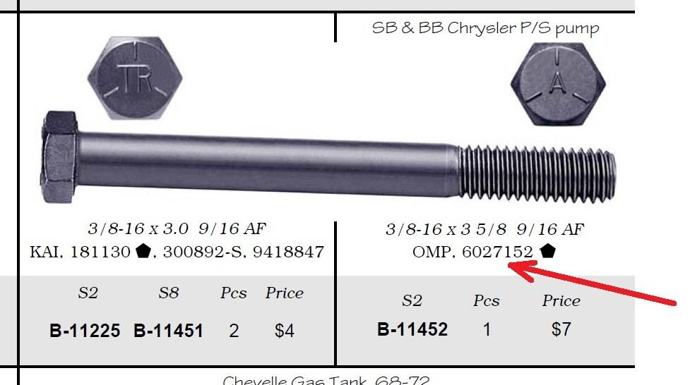

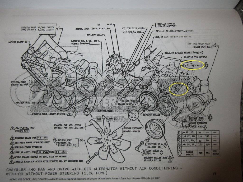

Looking for the proper bolt for the p/s bracket pivot point. Mine was a piece of cobbled together all thread. How does part #6027152 convert into a bolt size, length, thread, etc. that I can find?
Thx
From AMK products catalog. Might have one lying around but should be easy enough to find something to work at hardware store etc. The side pic doesn't appear accurate.
