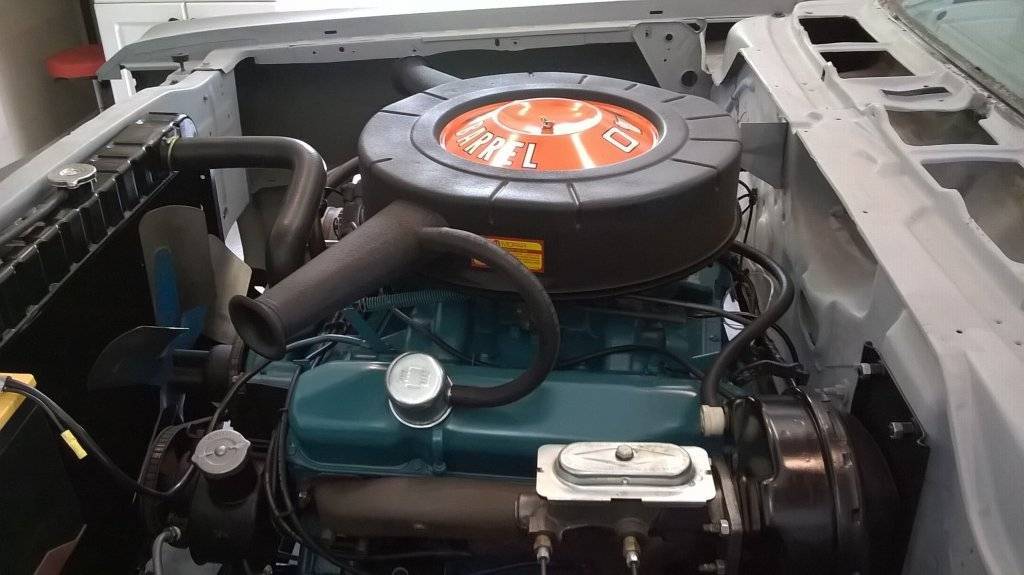

What makes the engine come back to idle slowly? I'm under the impression that a tight and healthy engine should come up to rpm fast and come down fast. My recently rebuilt engine seems to run good, while having good compression @ 150 on all cylinders revs up quickly, but is slow to come back to idle. Any thoughts on this?

That's exactly what I mean. Sitting in driveway in park. Hit the gas and rpm comes up fast but takes three to four seconds to slowly return to idle. It's not a big deal just curious if any one knows why.
All that rotational energy has to go somewhere and that takes time. I think all engines take a few seconds to wind down, there's no way it can do it instantaneously. What RPM are you buzzin it up to? I wouldn't worry about it.
Thanks for the input. Coming up to around 3500.
Check the return spring on the throttle linkage.
May be stretched/worn.

Are you referring to timing advance.
He is. Your modern DD uses ignition timing to correct idle speed all the time, it only changes airflow to make larger corrections. Also any small vacuum leak may lead to this complaint/symptom... or it could be perception.
Timing tests are covered in the FSM, with specs. Vacuum leak diagnosis gets iffy when your chasing a smaller leak that isn't really messing with idle too much. My best test for a leak without having to go shopping is to spray a heavy mist of water at all intake/carb gaskets on a warmed engine with a stable idle... you should hear a small rpm change if the water temporarily seals a leak. Keep in mind vacuum leaks could come from HVAC vacuum controls, brake components... anything with a vacuum hose. If you buy a selection of vacuum test caps you could easily block off all the external (to the engine) vacuum lines and verify if the issue is still present.
If you have no other issues with acceleration, cruising spark ping or operating temperature, you can simply continue to drive too...
Thanks for your input. Sounds like good advice.
I was trying to remember which way it effects, I believe it is too light of spring pressure will make it come on early and stay on too long which is what is happening to yours. a 3/32 allen wrench in through the nipple will adjust CCW will tighten ( make it operate at higher inches of mercury) CW will make it come in earlier/lower vacuum. I think you will need CCW, but I would measure it with a hand vacuum pump.
Thanks, I'll try that today. I had a feeling it was a vacuum issue just not sure which way to go with it, since pretty much everything is new. I don't believe I have any vacuum leaks, but it is possible so I will take cantflips advice and check that also while I'm in there.
