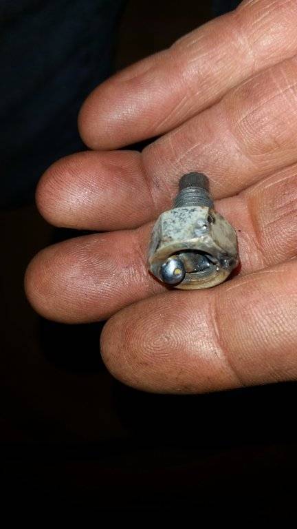

I have had a manifold leak from both sides for awhile now, and I finally got around to fixing one the passenger side today. Two broken bolts and one hell of a warped manifold. The manifold is at the shop getting surfaced. I should get it back in an hour or two. If you have 09-15 ram 1500, plan on doing this, it seems to be a problem with them.

Aluminum heads, cast iron exhaust manifolds...Differentt type of metals where they have different heat expansions/contractions. Hence broken studs.

As cbarge said it's not only dodge that breaks them. Remember when exhaust manifold bolts were 3/8 the 8mm they use now just can't take the stress
Yup well known problem on the Rams and it is the metalurgy that is the issue. No amount of antiseize seems to make a difference. Usually happens around 70-80k and usually rear most stud. Ford dealers have the big overhead cranes to lift the cabs off - crazy engineering going on there!

Drivers side was a pain in the butt. It took me twice as long to do. The manifold was not warped as bad but surfaced it anyway. I looked back at my paperwork for the truck, the dealer replaced all the back bolts when the truck had 6000 miles. They new something. I guess the 2012 and newer, this is all warranty work up to 80000 miles. I, unforturnately, have to deal with it myself or spend 1200 bucks at the dealer.
