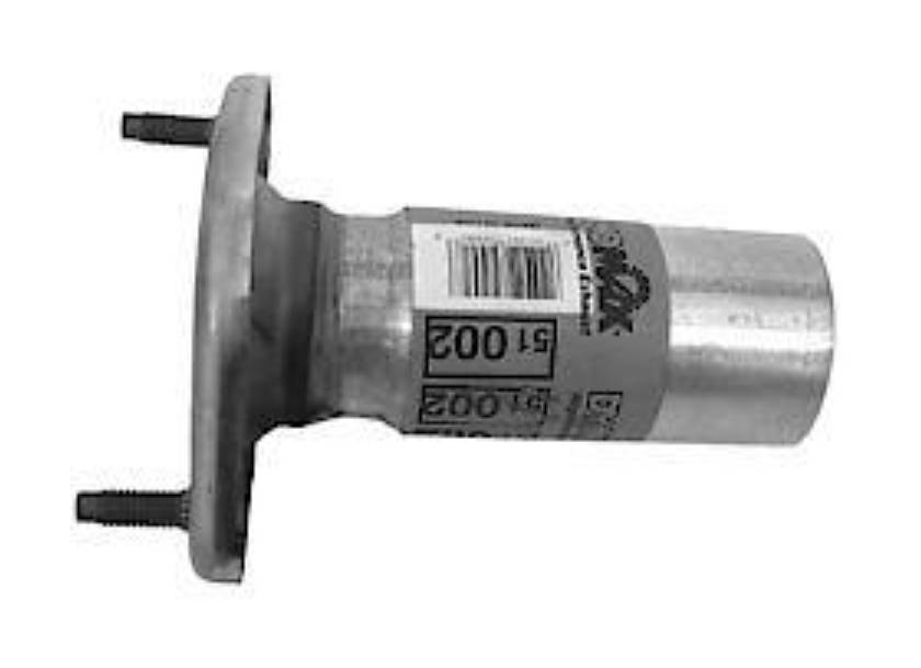

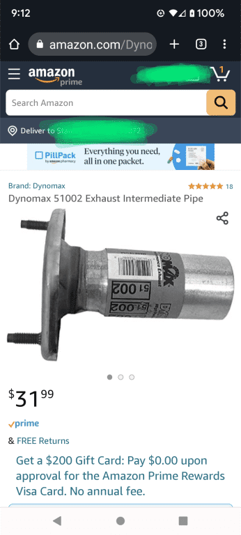

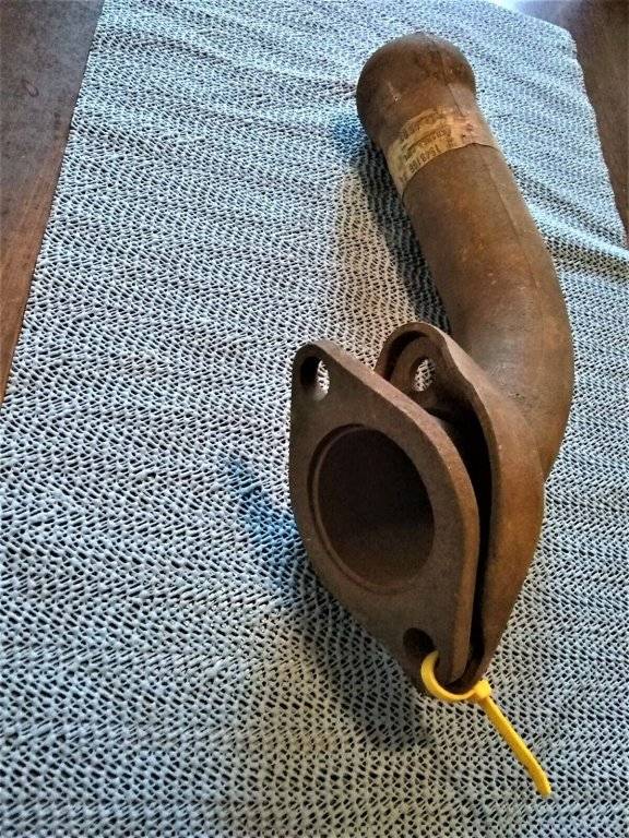

Does anybody have a clue where I can find a bolt on intermediate pipe or some call it the exhaust flange for my 66 fury VIP with a 383. It was a two barrel carb and we just replaced it with a factory four barrel manifold and a street warrior 600 CFM Holley. I need to open the exhaust up a little bit and do not want to put headers on it. I am comfortable building the exhaust but I have to have something to bolt to the factory flange. I have Included a couple of pics of what I’m looking for. Since it was a two barrel car, and probably does not have the high-performance factory exhaust manifolds.

The factory flange is flat it’s not a donut type or a ball type. I am going to remove the rusty flange as well as bolts and replaced it with a new flange. Thank you very much for the information I appreciate it.
Yes, the factory flange (at that point) is flat and gasketed with a beaded metal flat gasket. The ball joint connection is at the end of that front pipe section, under the front floor area. Seems like that gasket has a 2.25" hole in the middle of it?

That’s mainly for a 3.8 L. I only included those pictures as an example I don’t know if either one of those actually fit.
Agree above. looking closer at the photo that 41806 flange with a flat face on jegs has threaded holes in it which won’t work. You could drill them out if enough meat around them So you can use nuts and bolts.
the 51002 with studs in it doesn’t look right.
