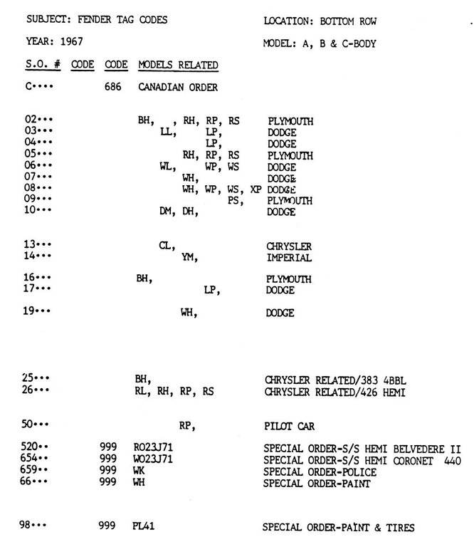

Someone on the forum has the Special Order prefixes listed; example 900908, where that first digit/letter has a meaning..another would be DT3511. Anyone know what I'm asking about? I've seen it here on the site, but can't remember what it's called or where it's at.
SO/VON assignments is a whole 'nother can 'o worms.
There are the often posted and wholly incomplete and out of context lists.
These are useful as a general guideline but far, far from definitive. What is listed may or may not be correct.
Context and applications matter!!!!! (A lot of exclamation points used on purpose for emphasis. You must know what year and make of car being discussed)
VON numbers CAN BE REUSED across makes indicating two different things.

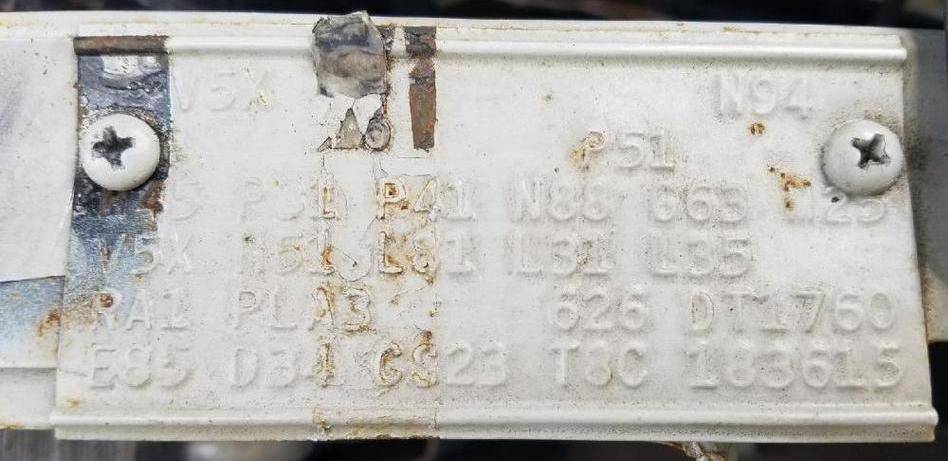

Thanks! One specific car I was thinking about was that infamous '78 New Yorker on BaT. It has the "DT" as the first characters of the VON.
DT1760, is what it reads.

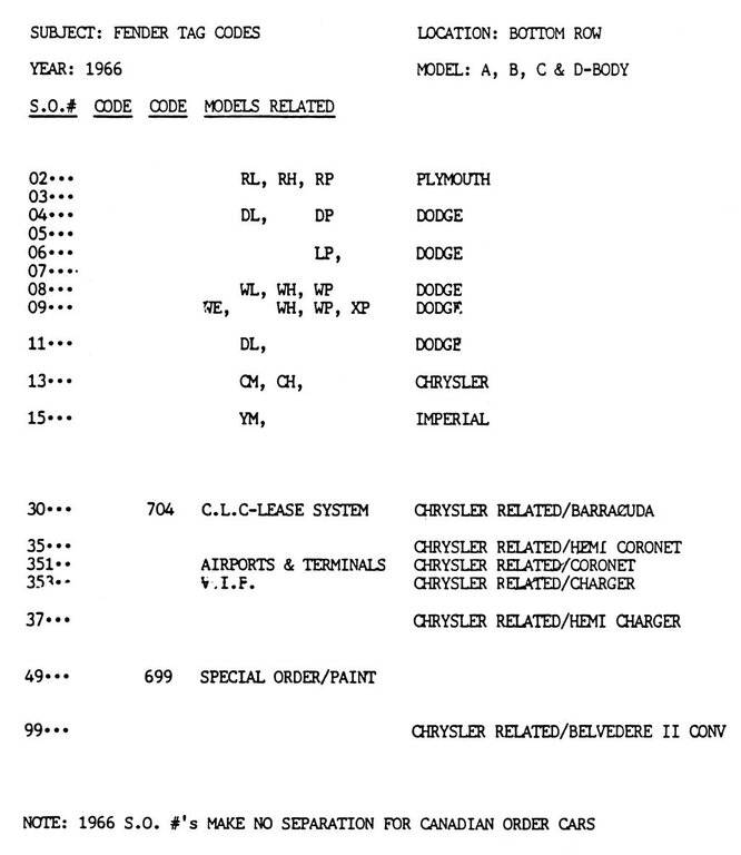

I see the code for my '66 Coronet 500 hardtop - 351---, which is "Airports and Terminals". It is the only one I've ever seen. In fact, it's the only one that Govier has ever seen, and this was back when we associated. My build sheet says "Airports and Terminals" at the bottom. My car was a display car for the new model year at Denver Stapleton Int'l Airport. It, along with a Dart, Polara, Monaco, and D100 were all on separate turntables to show off the new '66 lineup (Charger was unavailable until January '66). After Christmas 1965, the cars went back to the dealer, Skyline Dodge in Denver, to be sold.

OK, cool. Anyone out there with familiarity with 1978-up fender tags??? What do you believe the DT to mean? I've seen that on a couple of other New Yorker Broughams of that time frame in the past.

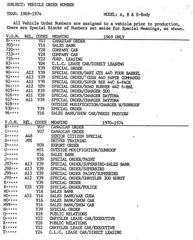

From 1978 on, normal US VONs started with two letters. Canadian and special VONs started with a single letter, eg. E "Export", J "Special Order/Paint", Q "Chrysler Lease/Executive" and B, C or D "Canada". On B-bodies K "Special Order/Police" was still in use. Note that a sunroof car in the list below did not get a special VON.

Looked at my '66 Coronet 500 SO number, it is indeed 35157, with the 351-- indicating Airports and Terminals; which matches the bottom of the build sheet. What's cool for me is that I did not know the 351-- meant what the build sheet said, in that regard, until yesterday!
And my '66 Imperial does indeed start with 15---.
That would be expected
66 SO numbers seem to increase as you go up the make/price point food chain.
For example, typical first numbers for 66' SO's are:
00- Valiant/Barracuda
02- Belvederes
02-04 C body Plymouths
06- Darts
08-09 Coronets
09- Charger
10-11 C body Dodges
13-Chryslers
15-Imperials
