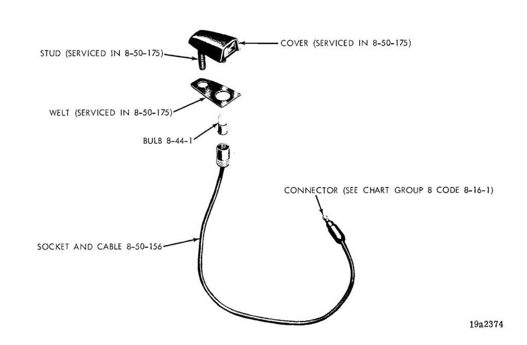

Well I would have said my search capability was proficient but maybe i'm using the wrong terms. So, i'll give up and just ask. How do you get to the fender top turn signal to replace the bulb on a 71 T&C? Does the inner fender have to come off or is there some secret access from the front that i'm missing?
Parts book have good pictures, this is the 69.
Alan
thanks for that. Do you have to remove the inner fender to access the nut?
Remove the stainless trim from the fender w/ the screw removed in the following steps. First apply masking tape to the fender on both sides of the trim to avoid scratching the paint. Next w/ your trim removal tool carefully pop the trim off the fender starting at the rear and moving forward. Raise the trim slightly and slide it out of the turn signal bezel. Now carefully lift the rear of the turn signal bezel and carefully lift it from the fender
