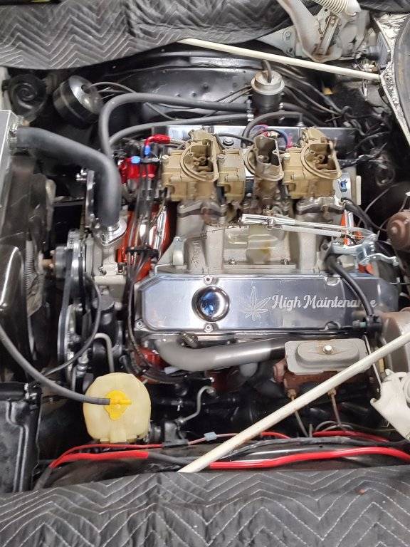

2 years ago I put 528 inch rb with a six pack in this bad boy.
The old power drums did stop it lol in a football field.

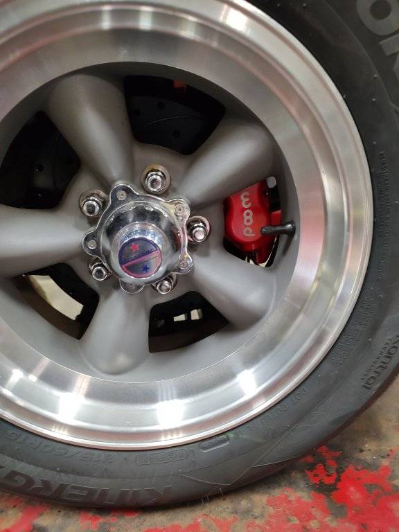

Doing Wilwood on all 4 corners. Along with a new fuel system.

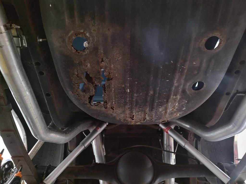

Front brakes were straight forward going on. Ball joints screwed right out with impact gun. Lucky... I found old stock moog tie rod ends upper ball joints and idler arm. The lowers are whoever.
Rear brakes not so good. I bought 8 3/4-Dana kit but the caliper brackets were for a Dana 35. So here I sit waiting on drop ship and that will be 5-7 days .
Wasn't planning on the fuel system just yet but while it's stuck on the hoist might as well take advantage and knock it out.
The old 5/16 line just won't handle them carbs when they open for long.
I don't feel bad about cutting the well out it's the only rusty spot on the car.
