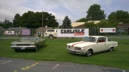

lets see some pictures of this 69 Sport Fury Vert :eek:ccasion14:
Here's the best pic I have so far. It has a 383 2bbl, ps, pb, That's my '65 Formula S with it. The Fury was driven just over 300 miles from CT to Carlisle and ran great.
