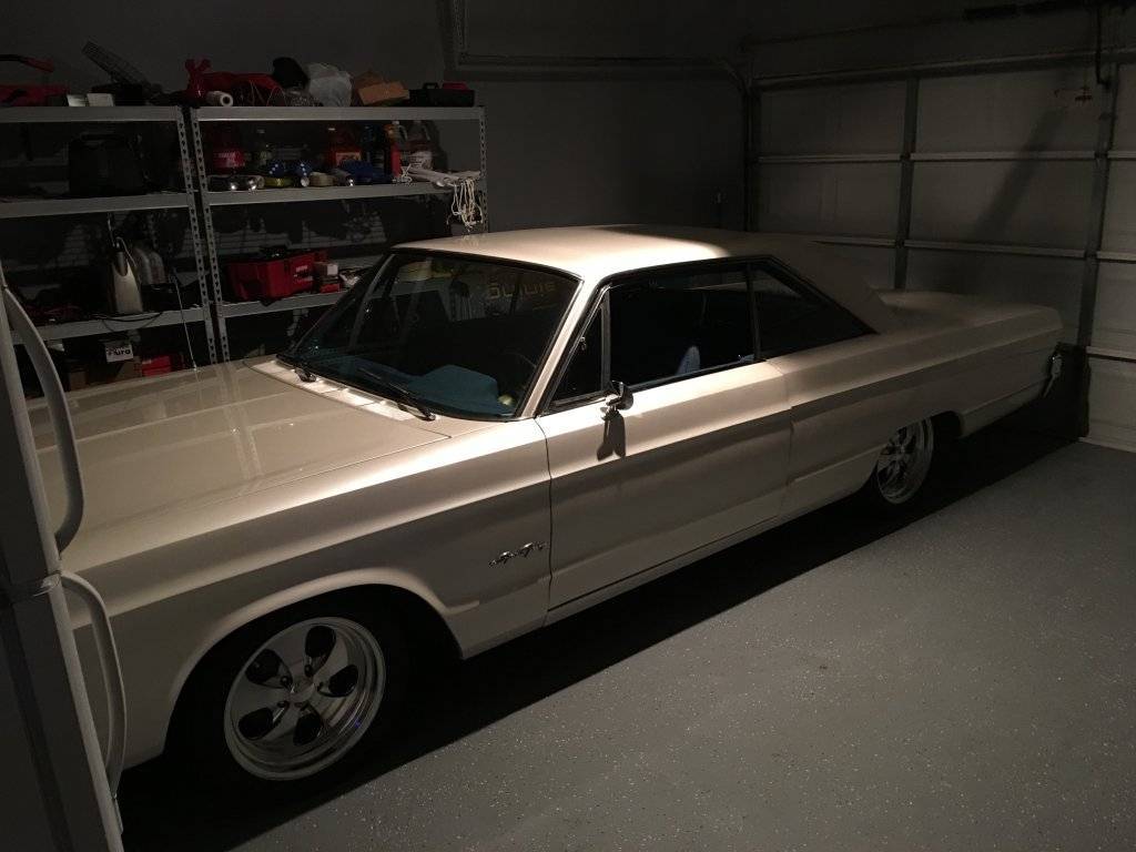

Been waiting on this car to be delivered for a week! lol might not seem like much to many but it felt like ETERNITY! Haha
Got it out a bit today aaaannnnnndddd promptly ran out of gas lmao... thank god I was 1/2 block from my dads house. Was able to double time it back home to get a can. No harm no foul.
For the most part the car is as advertised... it's got what appears to be a motor mount issue... the 727 doesn't shift into drive very gracefully, the exhaust has a bit of a leak and the timing could use some timing but all in all I couldn't be happier to be driving this beast.
Future plans include:
- Transmission Rebuild
- Front Coil Over
- Stroker motor
- Rear End Swap
- power adder
For now I will just ask questions and enjoy the banter... but this car was intended to be a 700+hp build and i still plan to do so
