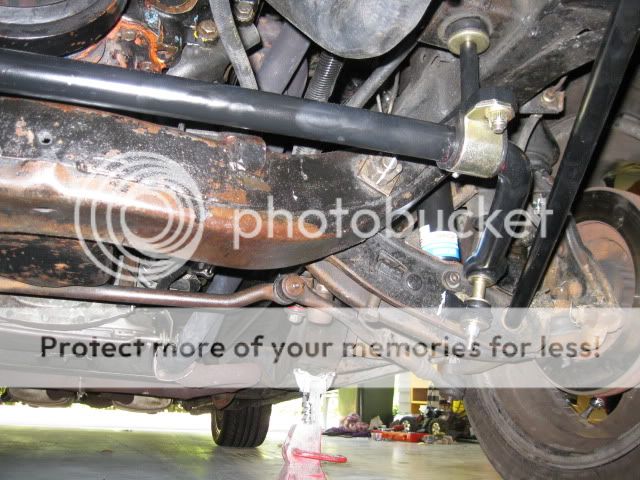

:tiptoe:Gents, I need a bit of advice before I commit myself by drilling mounting holes in my LCA for my new 1 1/4' Firm Feel front swaybar. So far I have mounted the swaybar in the frame brackets where the factory bar mounted. The new swaybar mounts to the LCA by means of 2 1/2' bolts that you must drill through the front side. Now my dillema is thus, the sway bar itself seems to hit the lip on the top part of the LCA on the drivers side while on the passenger side it almost tucks under the same lip. What I assume is the right way to mount these would be to have the bottom portion of the sway bar mount lie directly on top of the lip on the lower or bottom part of the LCA. When I try and line it up to mark the LCA the above mentioned problem occurs. If anyone has installed one of these bigger sway bars on their 69'-73' c-body please let me know what you did to make this work, thanks.:sSig_thankyou:
