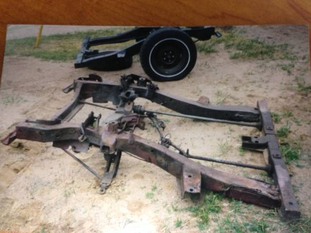

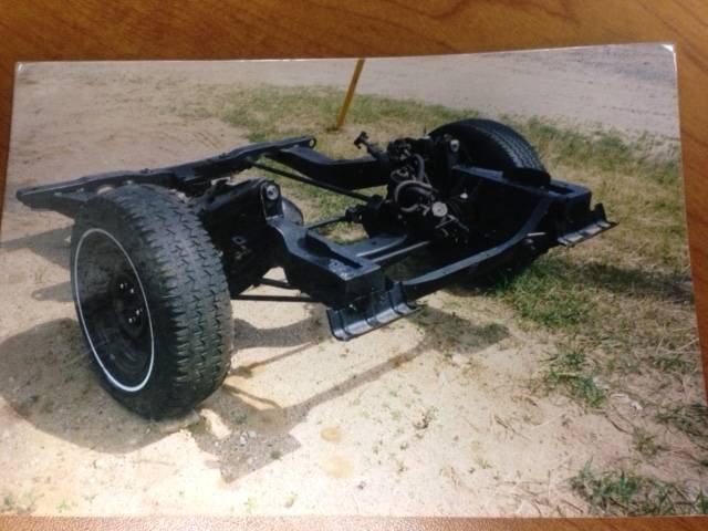

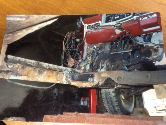

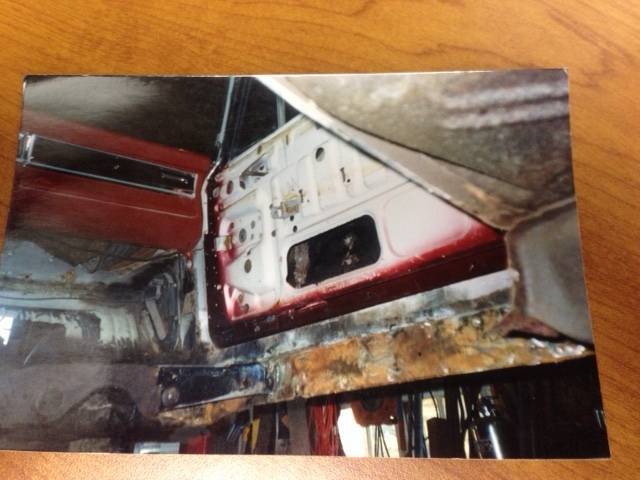

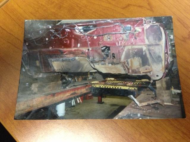

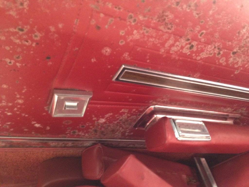

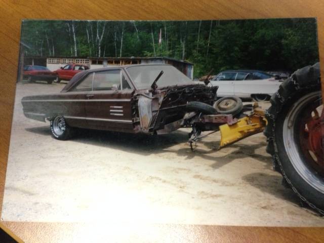

These photos were found in the bins of parts that I have. They were done before I got the car
Thought someone might like to see them. Some are them were shot up through the missing floor
WOW the PO was taking the restoration seriously. Good luck in completing the restoration.
