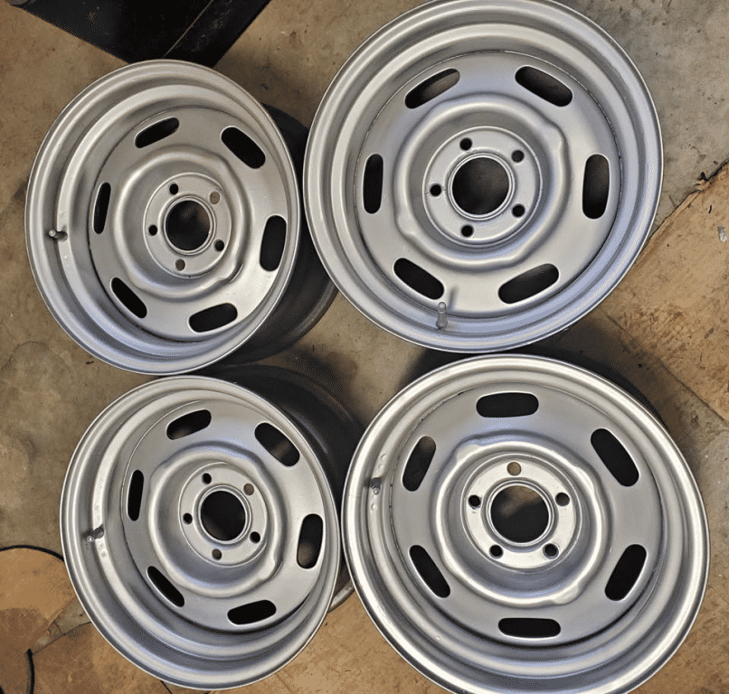

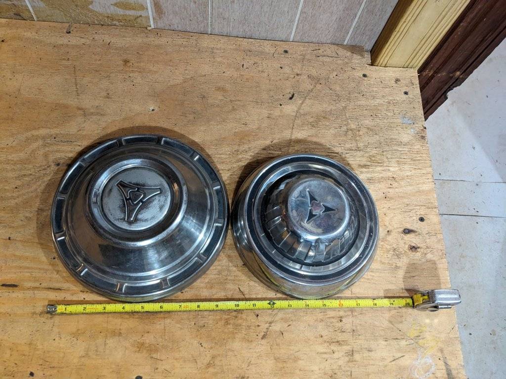

Hey all,

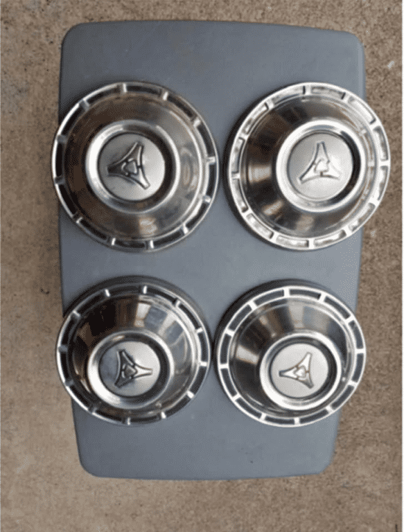

Will these dog dish caps

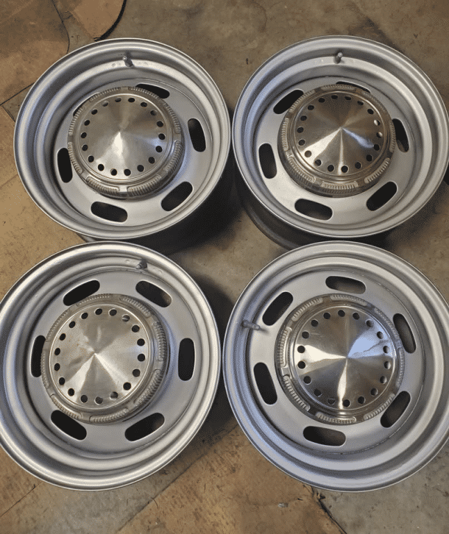

...fit these 15 x 7 cop car wheels?
Thanks in advance!

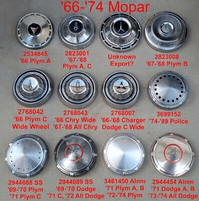

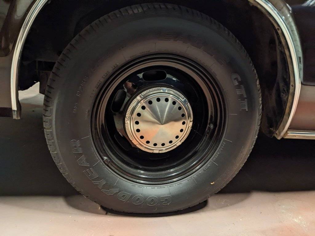

The pictured Dodge hub caps will not fit the pictured police wheels (Chrysler #3766077) without modification. Those hub caps are 10" diameter, but the police wheels use a 9" diameter cap. 10" caps were used through 1967 on passenger cars, then Chrysler switched to the 9" hub caps from 1968-1989, including the shown 15"x7" police wheels that were available 1978-1989.
Example of a 9" cap on the police wheels on my Newport:
Interesting - thanks - I was wondering how that could be done. If you come up with a source, please let me know.
Looking at the adaptors you posted - obviously they're a permanent weld on thing, and they don't seem to have what I would feel is the required compression bump and under-seat that would prevent the cap from working its way OFF the nubs once installed. In the original installation on the wheel, the cap has to stretch a tad to go over the bumps, and then relaxes as the cap's rim goes past and under the nub present on the factory rims. That way they're very likely to stay in place. The adaptors are simply compression with no underseat area, and I would think they might permit flex movement that would ultimately result in the cap leaving the wheel.
I was thinking of a spring ring that went inside the larger hub cap and provided the grip around the wheel's hub nubs. It would have to have a gap in it to allow it to expand and contract on installation as described above while still holding on to the oversized cap.

I would like to use the proper 66/67 Dodge doggies, but I'd like to get some sort of adaptor ring that allows me to use the wheels in other situations.

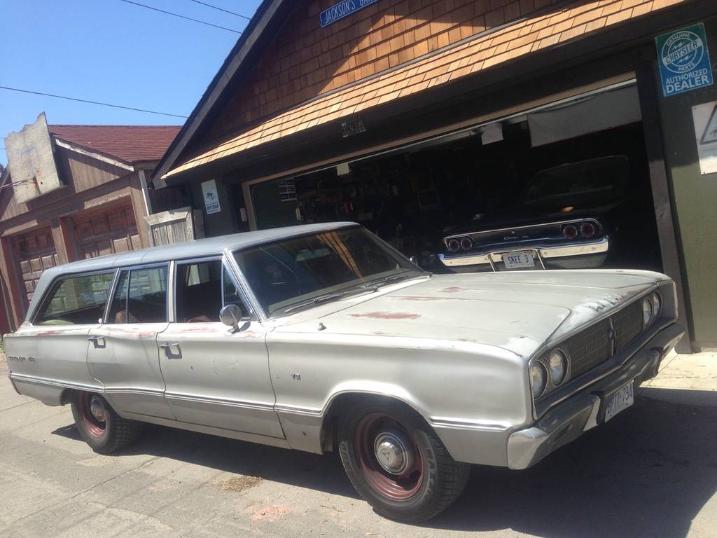

@Mike66Chryslers - how did you mount your lovely Chrysler ones?
