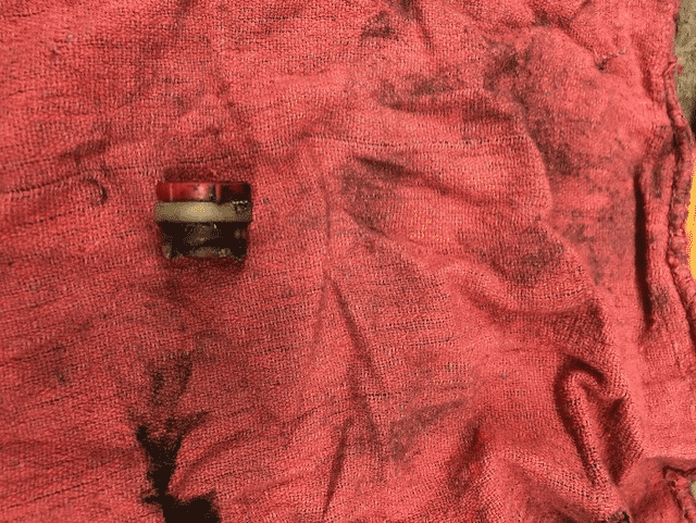

As I was changing my shift shaft seal on my 68 New Yorker, I noticed the linkage bushing on the transmission was kind of janky.
I looked one up, $34 for a plastic bushing?

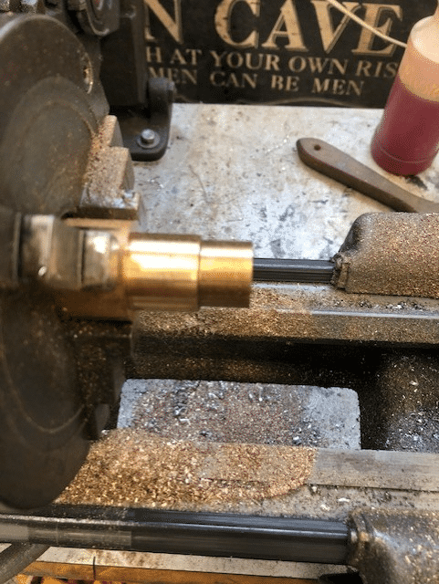

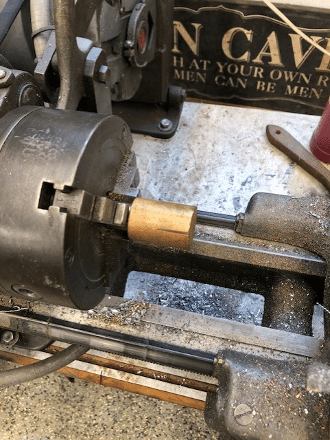

I didn't have a lot to do today and had some oil impregnated bronze I had used to make some bushings for an older snowmobile.
I got this lathe for free a few years ago from a fellow up the road who rebuild and races vintage Jaguars. I don't have any training on it so whatever I do is usually trial and error. I have made a few things. Anything I make on it takes about 10 time longer than a pro.

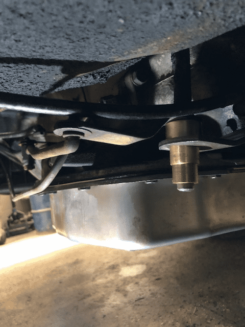

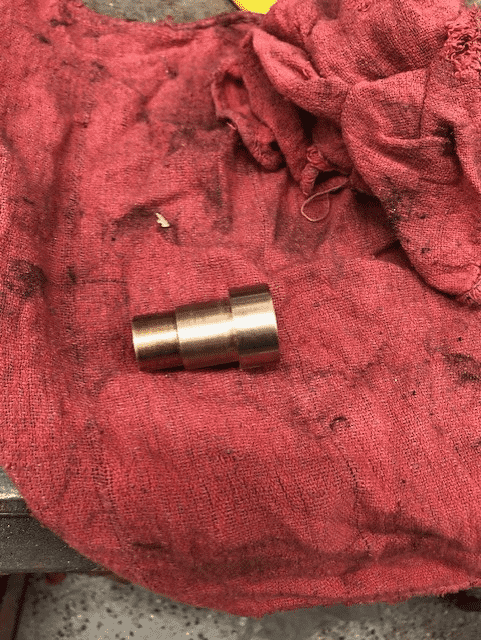

This is what I ended up with. I made it longer to give the shaft more support.
Installation seems to be ok.
