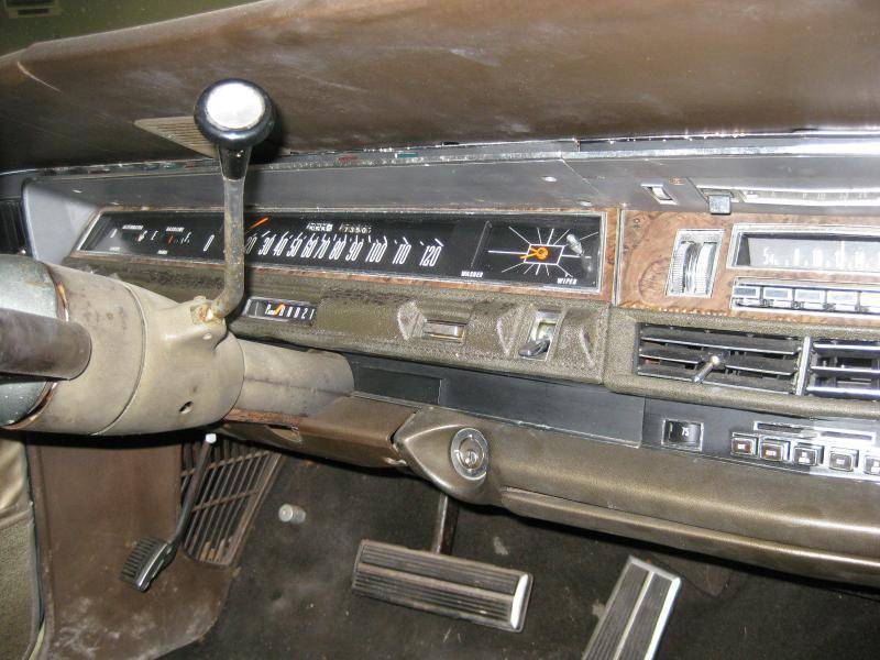

The '68 NYr I had before had manual heat and ac controls. I'm looking at buying another one right now that has auto temp control. I noticed that the levers on either side of the steering column that operate the floor vents are not there. How do you open the vents? Makes me silly having to ask.
Thanks
A 68 Chrysler C-body with ATC doesn't have a fresh air door on the right side, the ATC control unit is located in that spot. The left side is the same as non-ATC cars.

I've never seen one with ATC in person and I was provided with a picture looking the other way in the interior.
