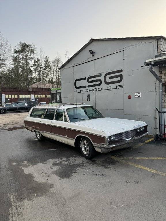

I have a problem. I live far away form the US and just bought a 1968 T&C.
I need a new flooring. For me it would be the best to buy it from Rockauto.com, because of the fast DHL shipping.
Rockauto offers ACC flooring, but not for T&C. But I also have a '68 2door fasttop Newport and the flooring there looks very similar (ofcourse missing the wagon part) and also I checked that Rockauto offers different product codes for Newport or Newyorker. Aren't they the same floor cars? Which flooring should I order then?
