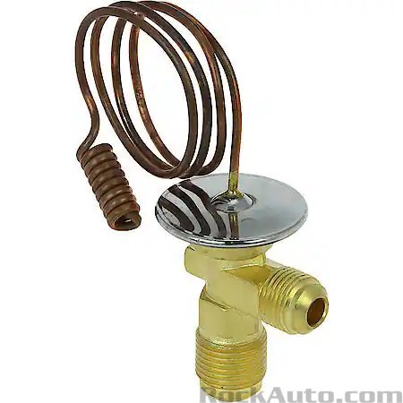

Unknown if this is a direct cross to the BPE 6044, but RockAuto has this single action valve for some Chrysler applications, plus others, on closeout for $5.66:
T38608
The valve is listed with unspecified "Famous Brand", but is likely CarQuest.

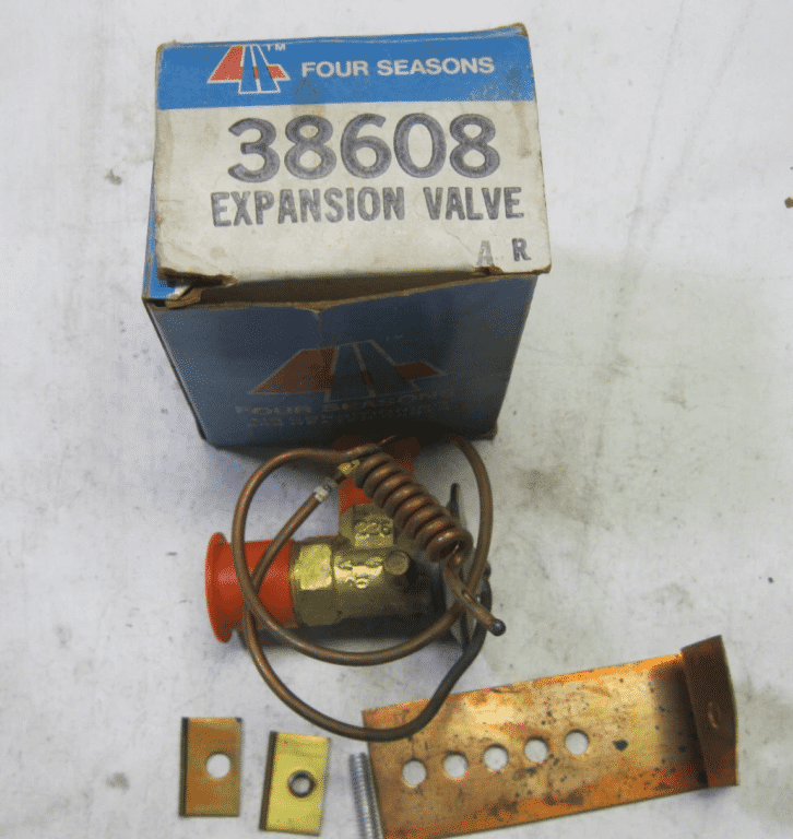

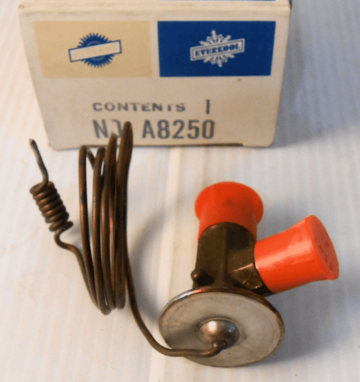

The Four Seasons and Murray number 38608 fits 1974-1979 dealer add-on air conditioning for Chrysler products. The Everco equivalent number is A8250. Most factory installations during this time period were the block style expansion valve.
There are several of the Everco, Four Seasons, and other brands of this type on eBay. I borrowed these two pictures from there.

Thank you. The pictured TXV have a flare fitting on the end, which my evaporator won’t allow. I’ll find it though eventually.
