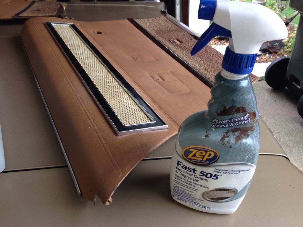

This is the stuff i used to remove the old hardened crap on my quarter window regulators.
Available at Home Depot.

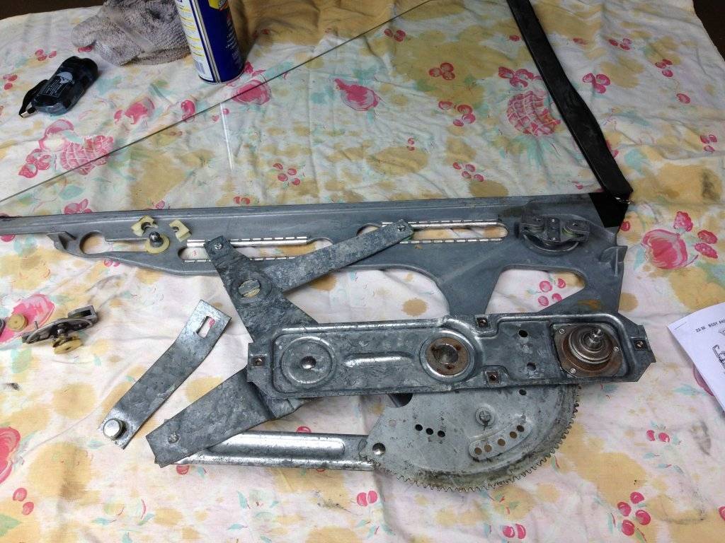

This is the reg. i removed to clean and repair. Keep mechanism lubed or break track guides like i did. Let the cleaner soak a bit and scrub with a small brush.
I was able to clean other side regulator in place. I removed inner trim panel and bracket at top of opening. Sprayed cleaner down thru slot each side of glass. After 15 min. dwell time i used a shower back-brush to reach down thru slot to scrub old crap off. I used a non-hardening garage door roller lube. They operate fine now.
