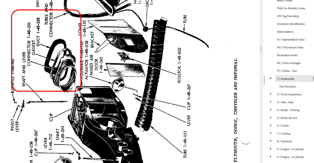

The fresh air intake hose on the 68 Fury (non AC) is boogered. It’s the hose that attaches to the heater box and the passenger side area near the kick panel (odd shaped oval).
Does anyone know what the part number is? And where it might be available?
Let me check my notes. I know that when I was restoring my 68 Polara I was looking for one but never found one. I ended up using cloth tape to fix it

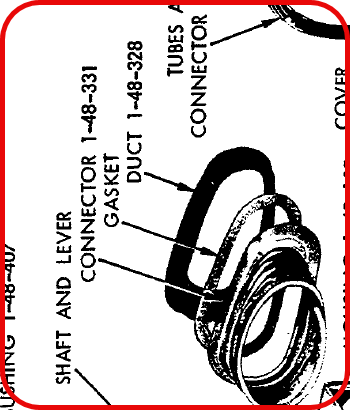

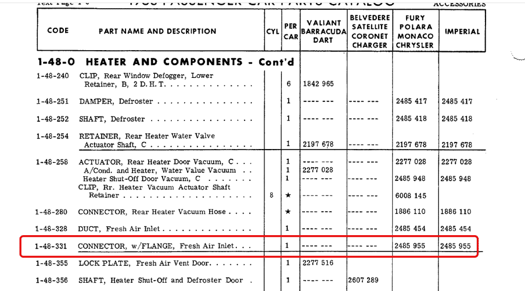

Here you go. The heater box stuff is in the accessories Section 1-48-331
I didn't have it in my excel file, but I had some other heater box gaskets that led me to section 1 -48
