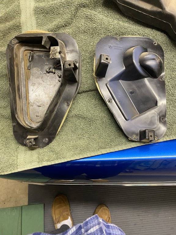

69 Dodge Polara…318 automatic originally A/C car. Bought it 3 years ago always thought PASSENGER side fresh air vent behind kick panel was broken. Driver side works fine. Took apart yesterday to find passenger side air vent has no vent…just a factory cover over it…but lever under dash and cable are there. See attached photo of removed parts. This surprised me. Is it the “norm” for A/C cars to have fresh air delete on passenger side? And yet have both levers under (steering wheel) dash? And even the passenger cable there not hooked up to anything? Weird…Can I expect it to blow fresh air if I can find a vent for passenger side? I would think so. Anyone have passenger vent laying around they’d like to sell? Sorry, lots of questions…just looking for some info. on this. Thank you….Bob
The cowl drains and vents in the areas behind the kick panel and vent covers. You will get fresh air if you install a vent. However, in every c-body car I've had, debris collect in that cowl vent area. When you 1st open the new vent and go for a drive, bits of old leaves may blow out into the passenger compartment. AMHIK. Shop vac is handy for this.

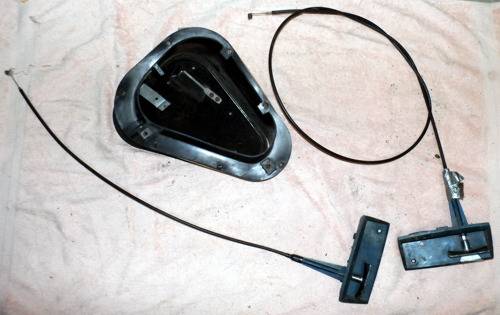

I have this, just one of them, don't know what side it's for, but it would be for '67 and also I assume '68 (and maybe earlier to '65 ?) so it looks like it's going to be different for '69.
Thanks for offering your vent…but yes, I looked up on eBay today and compared vents. 69-73 vents look to be different from yours (65-68 I believe). Really strange how factory put driver side vent in but passenger doesn’t get one. Car came with factory A/C. Not sure what Auto Temp vs Manual A/C is. Is that factory Airtemp vs dealer installed A/C? Car has no vent windows…unfortunately. I always liked those so much and it has tinted glass as well which looks real nice. And yes, I saw a nice pile of pine needles down in there when I removed cover this morning. I’ll vacuum them out before I install a vent. I put out some feelers today. Anyone know where I could look if no RH fresh air vent turns up for me? Thank you, Bob
