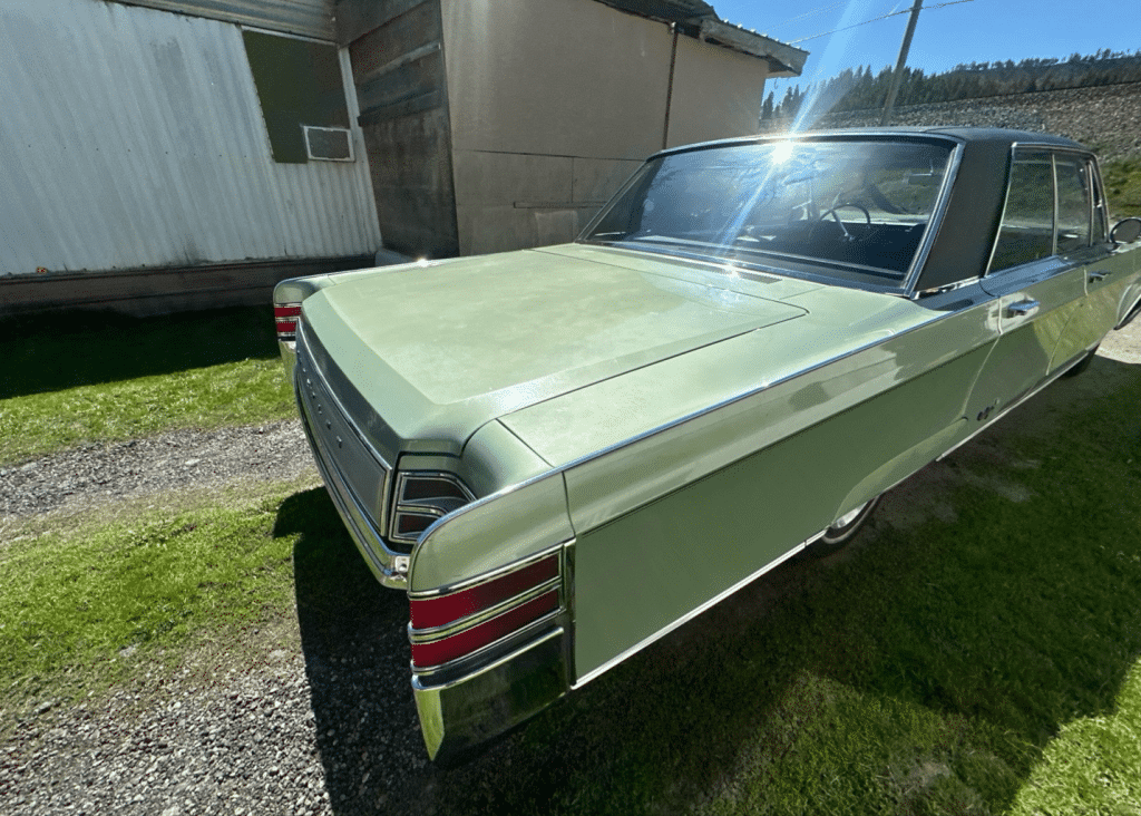

I haven't taken any pictures yet but I have the exact exterior color with black vinyl top and wheel covers pictured below. My interior however is black.
