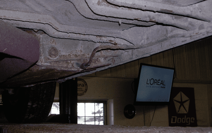

This will likely be hard to see. The round end is visible coming out of the frame rail. The line from the tank comes along the side of the body and will be trimmed to fit. I could bent the rear line so it would aim directly at the front line and use straight rubber fuel hose but would rather have it like it is in the picture. 90 degree molded hose would be simple.
The body fuel line should have two bends at the end closest to the front that bring it close to the engine bay line where it exits the stub frame, like only 2 or three inches of rubber hose at most, NOT bent very much if at all.

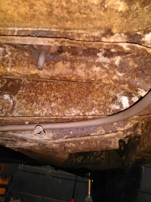

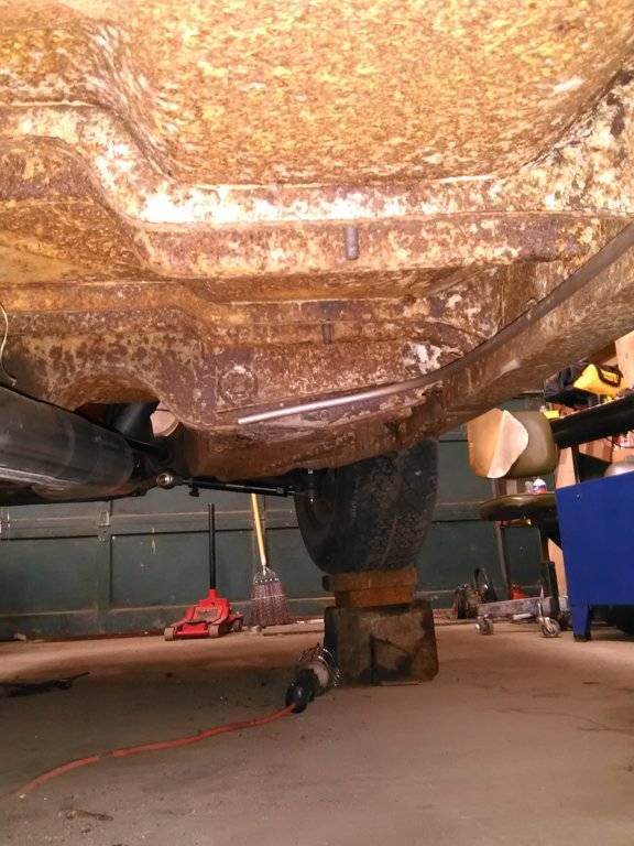

Yes please get me pictures of your line. I bent my own and copied the original. I used nickle copper and can bend it easily at crossmember.
The line from the tank should have two ninety degree bends that make it line up with the forward section of tubing. This is from a 65 Polara with original tubing but should be near identical.
OK I am pretty sure I know what you mean. Makes sense. I was liking the look of the line tucked in along the side and then in close to the crossmember.
That is EXACTLY what I was referring to, thanks Polara 500 for coming up with pics.
You can see the small bit of rubber hose that cobnects the two lines is straight.
In your pic I see your car on your 4 post lift and a flat screen in the background on the wall. Talk about making the you suck list.:poke:
