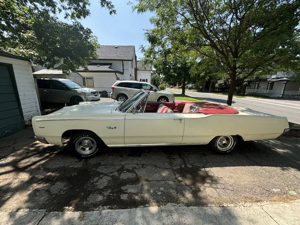

In September I picked up a 67 Fury convertible, 383, 2bbl. It ran, barely. And the fuel system was a gas can under the hood.

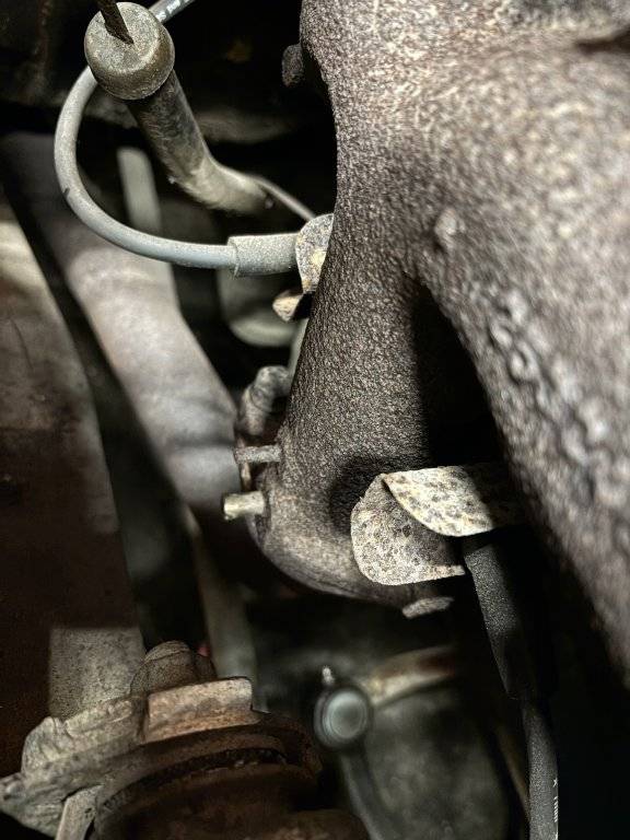

Last when it stalled I pulled the breather off and looked in the carb to be sure fuel squirted in when I pumped the accelerator. There is fuel, but I hear it sizzling in the carb.
So assuming I’m boiling fuel, where do I run the fuel line? Currently it comes off the pump, up behind the alternator, turns by the upper rad hose then into the carb. Is this factory? Will heat shielding sleeve over the line be enough?
