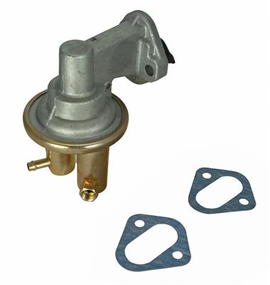

Thanks! Looks like it is just bolted into the block with two bolts, right? Looking at pics I'm assuming you undo the two lines going into it, mark them as to which goes where (but it looks like they use two different connections so might be dummy proof) and then undo two bolts that connect it to the block. Does the mechanical pump work by having the lever coming out the back of the pump tap against the cam or something and then drawing fuel that way (via mechanical vacuum or something)?
http://www.summitracing.com/parts/crt-m3672/overview/make/dodge
One last question. Is the cylinder next to the pump the fuel filter? I'm assuming so and I would be wise to replace both at the same time surely.
Yes that cylinder is the filter and should be replaced at the same time and don't cheap out on it! The pump runs off the cam but has a pushrod that needs to be pushed up as you're inserting the arm of the pump in the block. Sometimes tricky but usually not.

When you put in the new pump, the arm sticking out sits on top of a cam lobe and you then press down on the pump and snug it in and up up against the block to remount it. Very simple.
I just replaced the fuel pump on my '67 Monaco 500 (383). There is a plug, with a hex head, just above the fuel pump. Take off the plug and the push rod should drop out. When it comes time to put in the new fuel pump remove that push rod or it'll be in the way and you'll never get the pump in place. Grease the push rod, which will hold it place and shove it back into the hole. I used a screwdriver to gently push in as far as it would go. Then I quickly installed the new fuel pump and got everything tightened down. And 'bingo'! Hope this helps!

I have my new fuel pump on, but I'm kind of concerned about it. I see the push rod in there, and I felt the hex key. The push rod didn't fall out of the block when I took the pump off. How does the rod work? I was expecting the rod to sit on and tap the end of the top side of the plunger on the pump. But with the way I see the rod in the block and the way the pump went in, I can't imagine how that would work. If I had x ray vision, I would expect to see the plunger riding on top of the rod the way it is now.
Am I making sense to anyone?
The pushrod won't come out unless you remove plug in the block below the pump. The rod rides on top of the lever of the pump.
With the pump removed the push rod normally, but not always, slides down but not out of it's bore. A little bearing grease applied to the rod will hold it in place once you slide it back up with your finger. Then install the pump.
