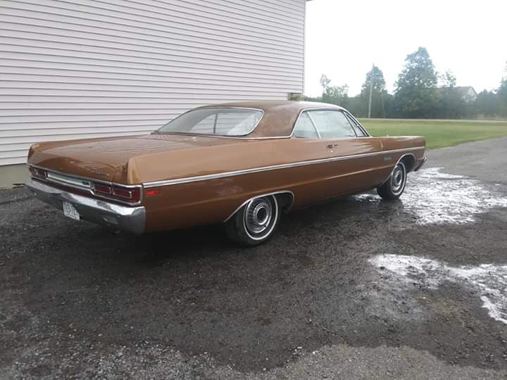

Try looking for a radiator shop that renews gas tanks.My work had a 68 Buick Wildcat and the tank is no longer available. Local rad shop flushed out the original with no issues.
I did the original tank for the 69 Fury and was 250.00 cheaper than a new tank.
No leaks and no more rust inside.
