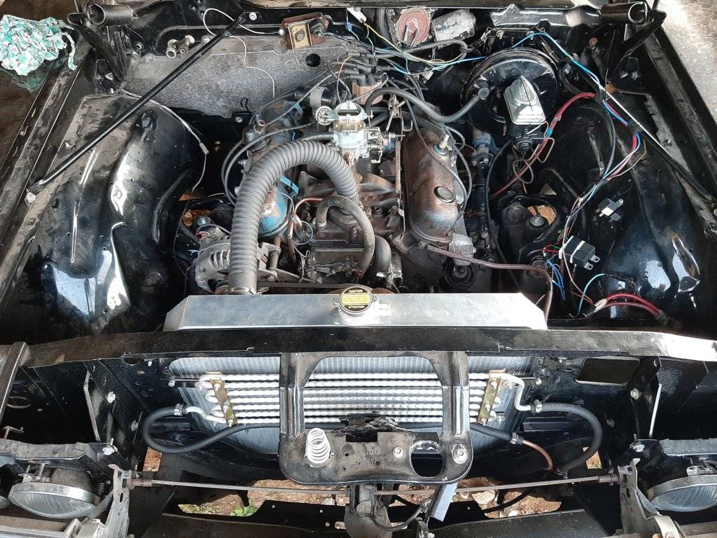

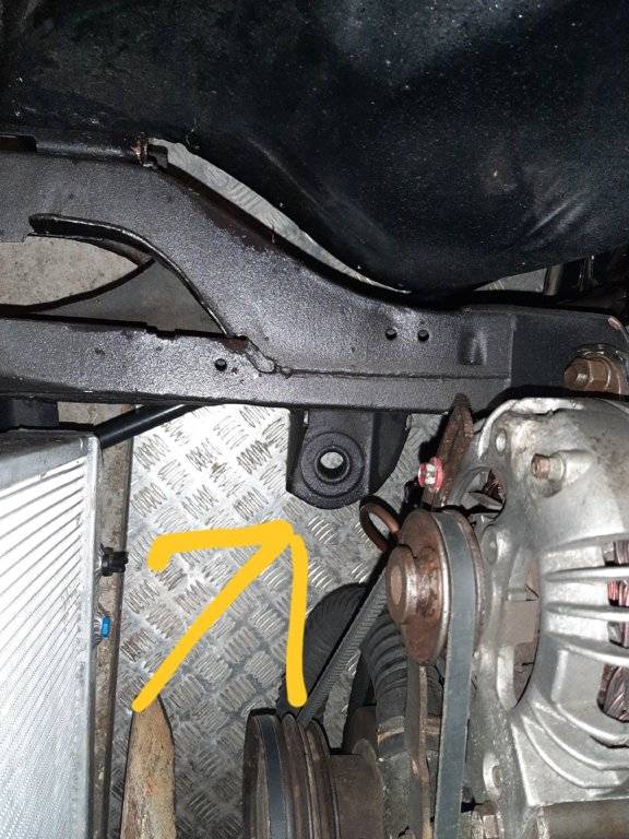

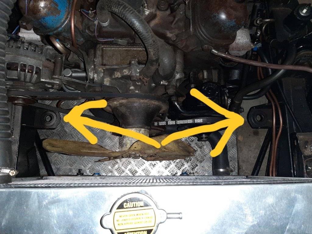

I have Fury coupe 1971 PH 29.
What are these brackets in the engine compartment for? Yellow arrows.
Where can I see quality photos of the engine compartment in stock?
Thank you

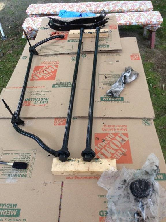

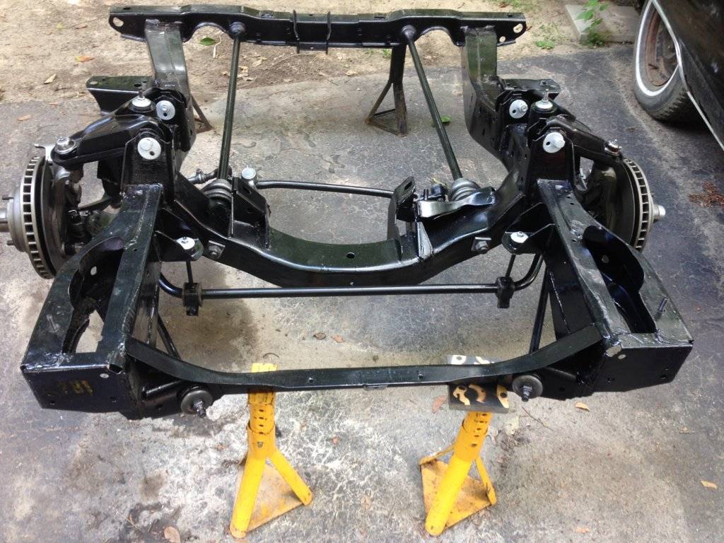

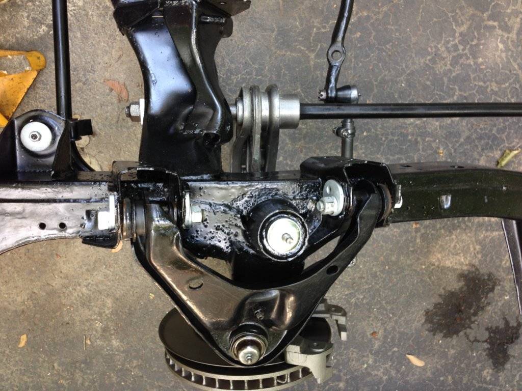

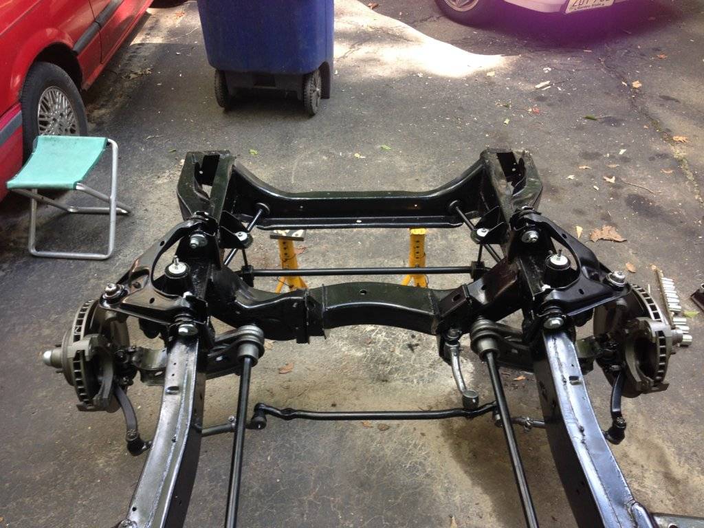

Those brackets are for the front sway bar.
Better shot of it from the front:
This is what it looks like out of the car:
Thanks a lot! Very useful information! This means that the stabilizer is also lost.:(
Easily obtained in the states. I have an extra one but it is long and heavy and probably very expensive to ship to Russia. On the other hand, just because the bracket is there it doesn't mean it originally came with one.
Yes, that's right. I'm looking for a cheap donor from America. If I'm lucky, it will bring a lot of the right parts.
