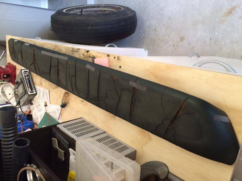

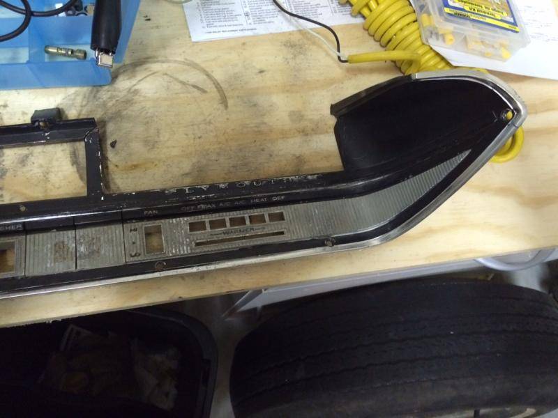

Commando1 - The plan for the dash pad right now is to flake off all the crispy vinyl(?) to get to the underlying foam. There are a ton of gaps in the foam, so I need to figure out what to fill it with (spray foam? Bondo? Fiberglass the whole thing?). Then I plan on wrapping it all in a thin layer of new foam then a vinyl cover. I'm open to suggestions on the best way to resurrect it.

The Horvaths - I'd love any advice or suggestions you are willing to share on how to restore the instrument cover. It looks like painted plastic and I was just thinking of masking off the silver parts and painting black and then vice versa for the silver parts and detail the raised areas (lettering) with a small paint brush. The plastic has cracked in a few areas, but I was able to get it back together with gorilla glue.

OK, my suggestion would be to tear out the entire dash including the instrument cluster and do it all at once. For the lettering, I would highly recommend using "Sign Painters' White Lettering" paint. I found that dipping a pencil eraser into a small amount of that paint, and very carefully pressing the eraser onto the raised lettering will yield the best results. Abviously, I would do this after painting the main colors first. If you drip any white paint, you can apply the correct color over it with a q tip. Gorilla glue or silicon works well for repairing cracks. As for the instrument cluster, remove the plastic cover and mask the dial very well. I used a roll of paper to do this. Make sure you do not touch the dial, as the paint will rub off. You can use a small spray can of bright fluorescent orange to paint the indicator / pointer. Let it dry thoroughly and re coat. You can make your plastic dial covers look better by polishing them. You may also want to restore or rebuild your AC box or heater while you have your dash out. I can post pictures when I get home, if you would like. Good luck, and let me know if I should elaborate!
