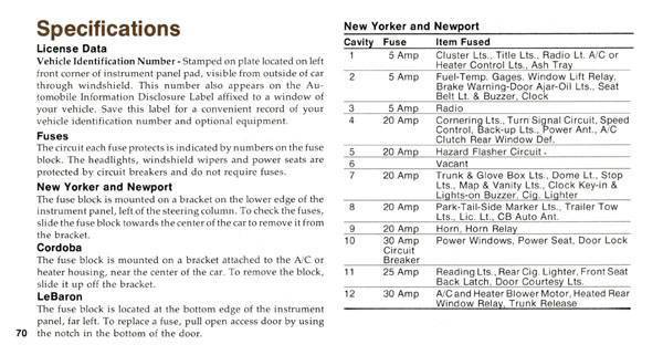

Nov 7, 2015 #1 patrick66 Old Man with a Hat Joined Jul 4, 2012 Messages 6,737 Reaction score 5,492 Location Central Oklahoma Does anyone have a diagram for the '78 New Yorker fuse box and fuse/circuit breaker placement???
Nov 7, 2015 #2 Mr C Senior Member Joined Nov 20, 2012 Messages 4,599 Reaction score 4,587 Location Winnipeg MB, Canada Does this help? It's from the 78 owner's manual...
Nov 8, 2015 #3 patrick66 Old Man with a Hat Joined Jul 4, 2012 Messages 6,737 Reaction score 5,492 Location Central Oklahoma Sure does, Matt, thanks.
