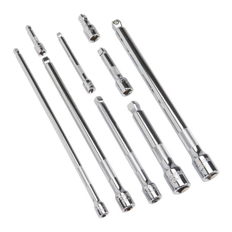

Long "wobble" socket extensions and/or u-joints (wrap them with tape to stiffen them up) are your friends here.

I got the mirror out and in with a tiny socket and wrench after tightening the mirror to the base.
