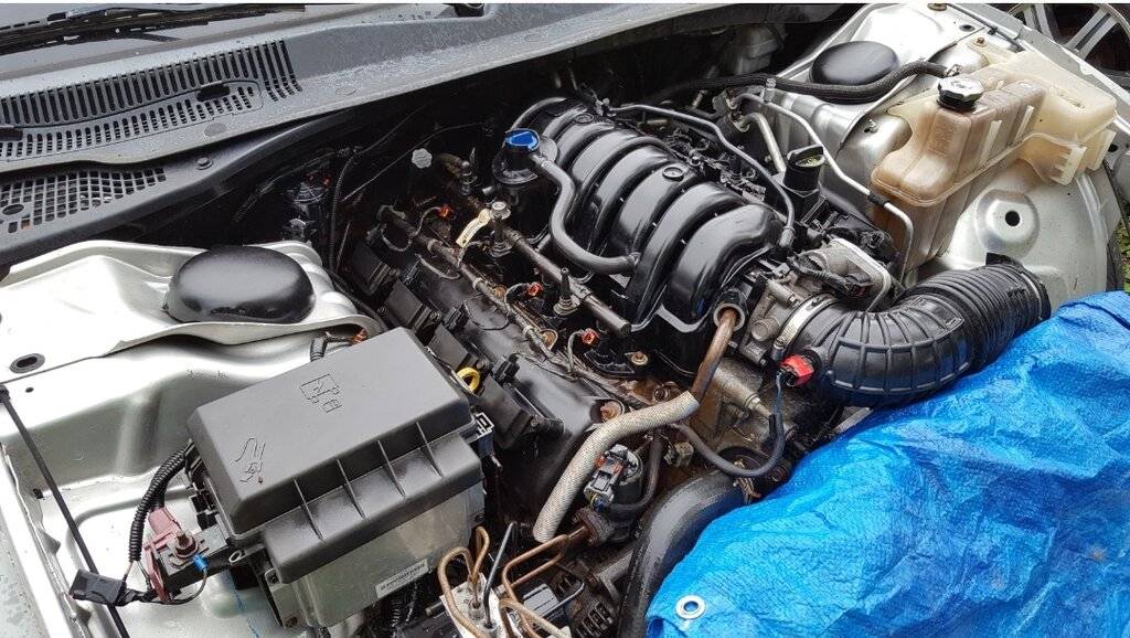

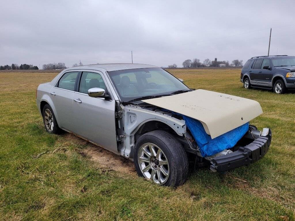

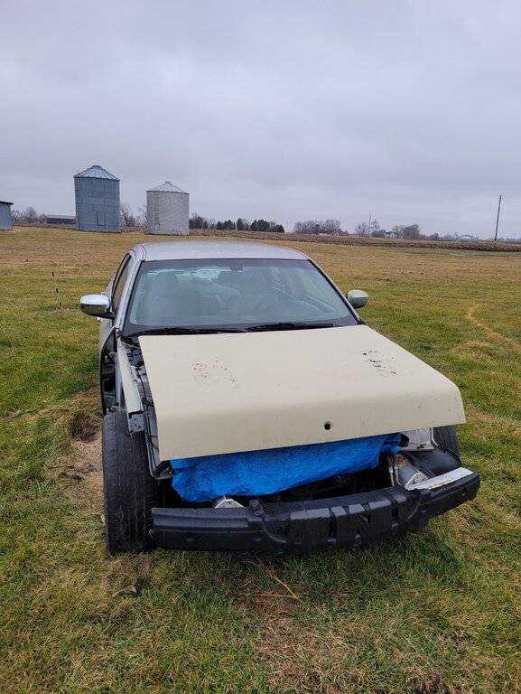

I bought this wrecked 300C and needed something to protect the engine from the elements, thought you guys would get a kick outta this as much as I did.
My intention is to get this drivetrain into a C body next year, but I still need to do a lot of research...any suggestions or links to others that have done this is appreciated.

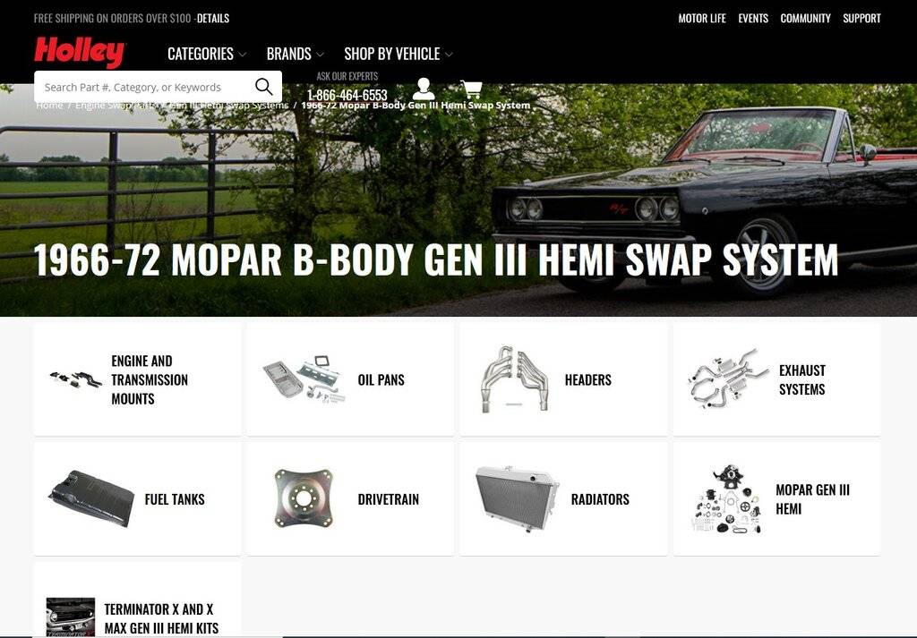

Apparently, Holley sells everything you need to put the engine in a B body, making it almost a completely bolt-in affair. I'm sure that some of the B body stuff will work on a C body.
1966-72 Mopar B-Body Gen III Hemi Swap System - Holley

Yes you can use some stuff but you still have to do some fabrication to make it work, as most know I’m running an Eagle Hemi in my 70 Fury and I love it even my wife’s drivers that car no problem long distance.
Both moparts and FBBO have a bunch of people doing gen III stuff.
The white label stuff from Holley is pretty affordable and well featured.
Their new front cover and accessory stuff, while not cheap, is a pretty cool solution for running AC and ps and not having to hack your k member.
