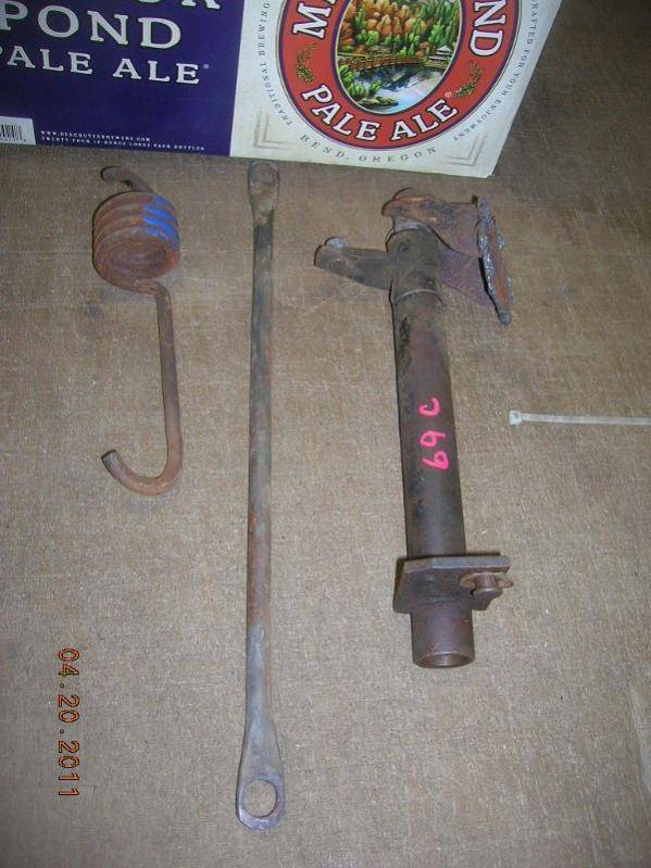

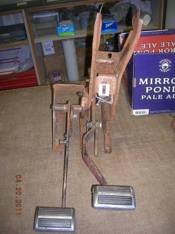

Well i found a peadal asembly complete out off a 69 C body manual 3 speed , price is high but where you gona find one , 300 bucks,4 speed here i come :happy7::upside down: , 4 speed bench seat got to like it.

Well i found a peadal asembly complete out off a 69 C body manual 3 speed , price is high but where you gona find one , 300 bucks,4 speed here i come :happy7::upside down: , 4 speed bench seat got to like it.Jim
:wav:..Nice, keep us posted on progress......I myself would rather not have one but good for you...:congratualtions:
