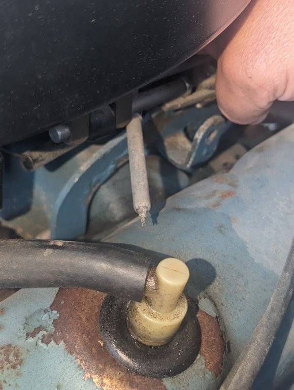

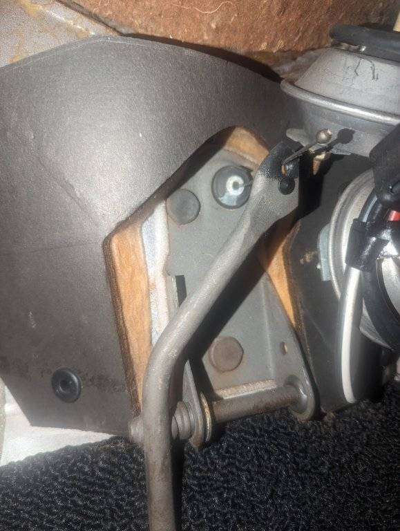

I have a 72 fury that I acquired when my dad passed away. I don't know a whole lot on cars, especially older ones so hopefully someone can help. I went to go drive her today, and as I pressed the gas pedal, it snapped and the pedal went to the floor. I don't mind getting dirty and trying to do the job myself, I just have no idea what part I even need, or where to look. Google hasn't been too helpful. Any help in pointing me in the right direction would be greatly appreciated.
One of about 3 things happened. All under the hood.
The return spring could have snapped or come off. Next is the throttle cable came loose from the clamp. Third is the cable snapped. I doubt that happened, but just covering the bases.

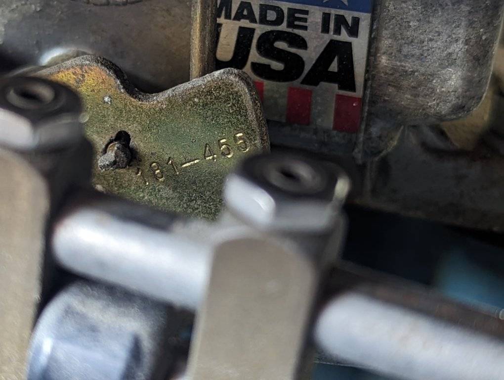

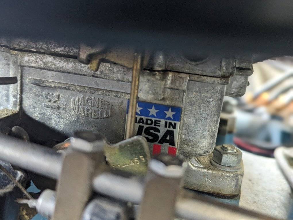

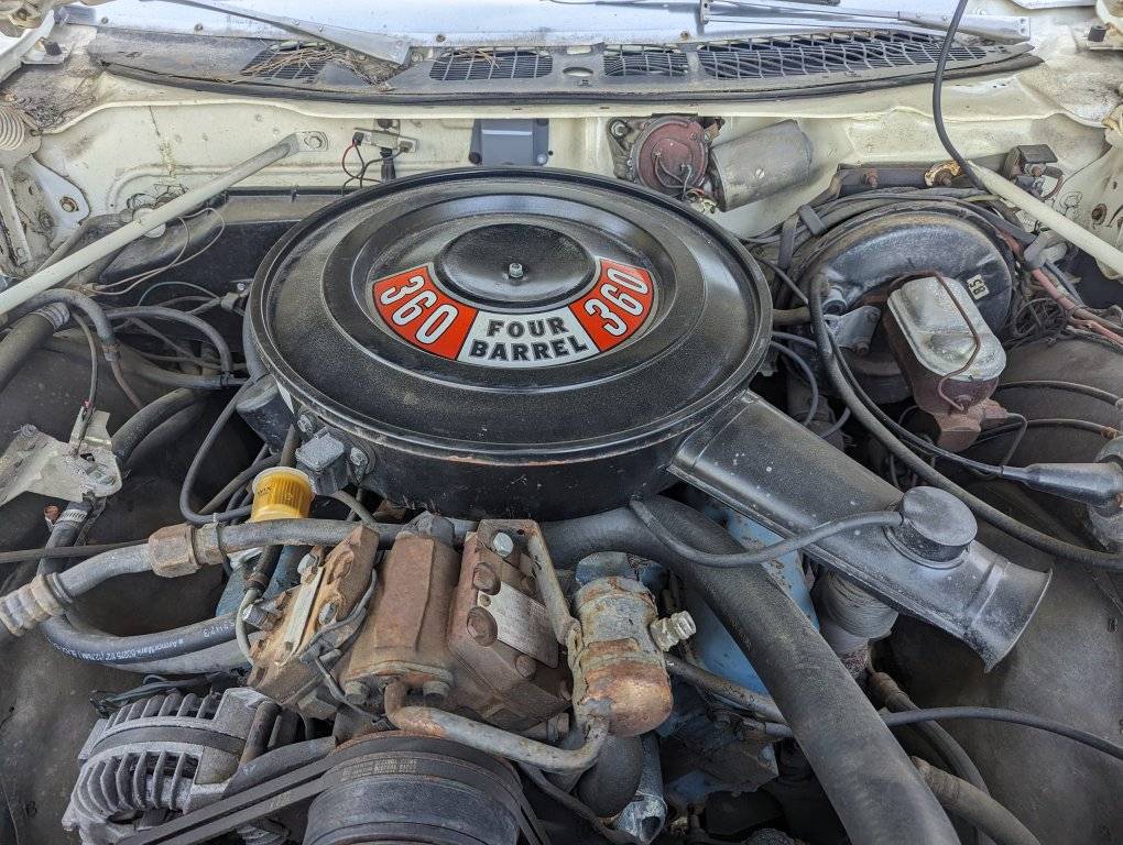

So, open the hood, take the air cleaner off and have a look. If you aren't sure what you are looking at, take a few pictures of the drivers side of the carb and we should be able to identify your problem.
