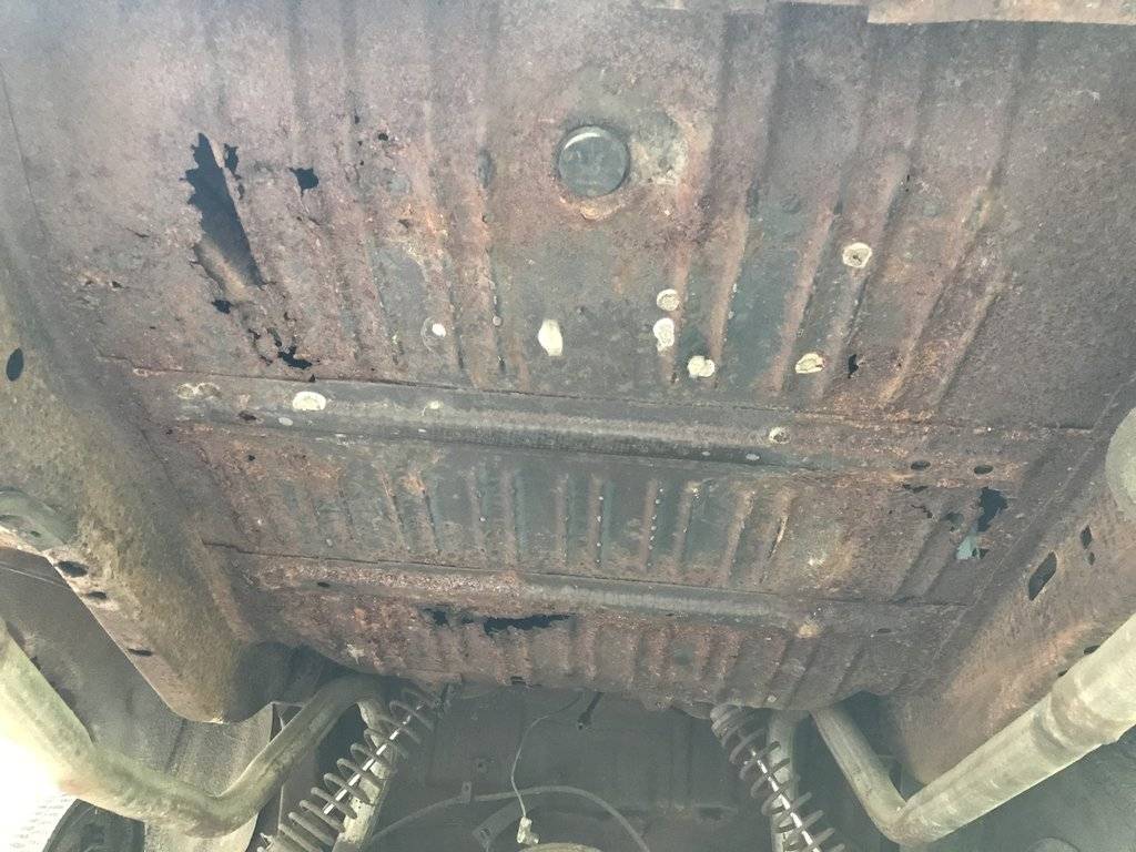

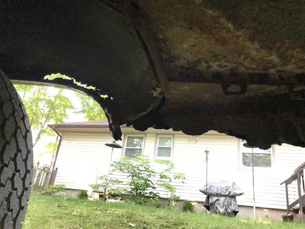

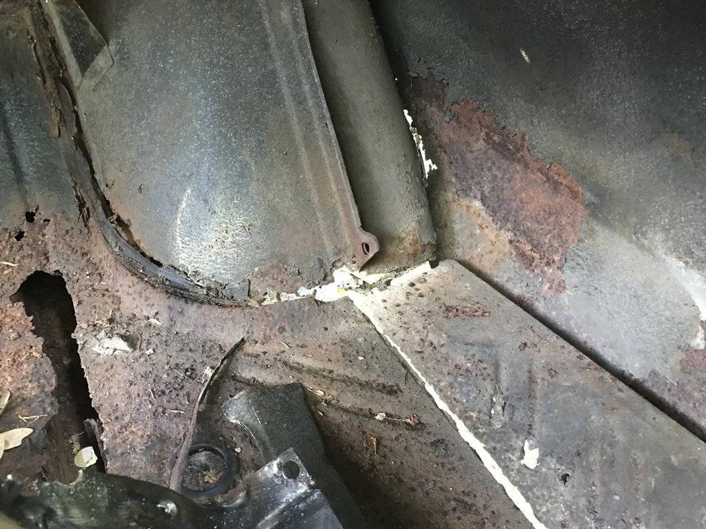

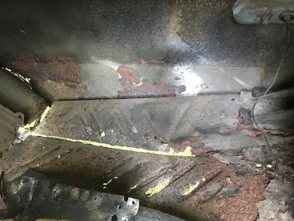

As an aside, here are some views of the trunk I'll be pulling out next week. I'm still tring to decide if this one is even with the trouble, or I should pass it on.
Personally I would take that job on as i do a fair amount of metal work. I have been thinking of purchasing a car that has a mint condition trunk floor and would simply unstitch the whole floor and replace it, also the outer extensions too. The lower quarters i would hand form some sheet metal and weld them in. But, if you don't have a spare floor, it would end up being a lot of work.
I have seen your work, inspirational comes to mind!
Yes, I have solid replacement metal all around, and it will need it. Trunk, quarters, front floor pans, and front and rear window frames. I planned on starting a thread, but I'm still on the fence. I still think it deserves to be fixed and not used as an organ donor, but with the motor-less vert in the garage, it has been tempting at times.
Focus on one car! Get the convertible done and worry about this one later.

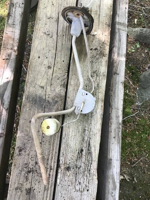

The tank might be wasted, but it looks like the sending unit had been replaced and is still usable.
