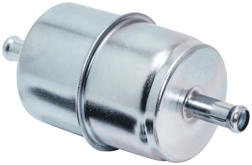

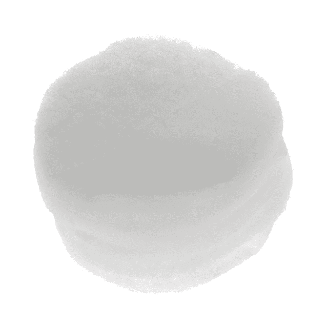

A dirty tank is a dirty tank. It happens a lot. And ain't no bug juice known to man going it eat it out of that tank that don't eat the tank right along with the dirty stuff. All you can do is filter, filter, filter...till the filtering is done. Unless its diesel fungus. There are bottle cures for that
I have to many old dirty tank cars to replace all the old dirty tanks.

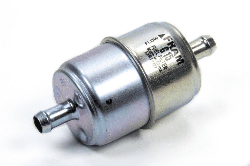

So, I blow the sock off the pickup or blow the sock to pieces. Yes, they can and sometimes do clog up. Then I relocate the fuel filter that Mopar put just before the pump to a higher easy to access location and keep changing the filter. Maybe ten miles the first time, 40 the second time, 200 the third time... and so on. Whatever it takes to get clean gas to the carb. I always get to a point where they don't clog.
And yes, I defiantly use (you would too) the "clear plastic" filters so I can see when it is about to jamb up. I use two of them in line. First one dirties up in short order, second one maybe never, it depends on the offending tank contaminator.
On some cars a few filter changes does the job, on some I go through a dozen filters, or more. I buy them 20 or more at a time at $1 apiece from Temu.

A dirty tank is a dirty tank. It happens a lot. And ain't no bug juice known to man going it eat it out of that tank that don't eat the tank right along with the dirty stuff. All you can do is filter, filter, filter...till the filtering is done. ....
When we first acquired Gertrude, the original tank had been half-*** patched up top, where weather had rusted it through. Then, barn rats chewed their way into that tank, and denned there for some decades. Suffice to say, that tank proved irremediable, and I shitcanned it to the street after the first week, and the 6th filter. Yes, after trashing the first good Wix filter in a day, I got half a dozen cheap see-through sino-plastic ones, likely from the same plant those you get from Temu. Thanks be to St. Joe, we had the perfect, immaculate tank from Mathilda, which the previous owner had installed and which I scrupulously maintained, as I still do, so I swapped it right in after that first week of ratshit clogging filters, petrol slopping up into the trunk and other fun stuff. The old tank cracked open upon my removing it, and THAT was when I SAW the rat skeletons. Get this: that tank didn't even sit on the street for 24 hours, Some nitwit thought it could use it and took it. I doubt any competent scrap metal buyer would want it, but fools abound.
Sho' 'nuff!
I put my see-thru ones just before the carb, using rubber line all the way to the metal one coming out near the right fender. I got to the point where no filters clogged.... when I put the CLEAN TANK on. Any future buys will include rigorous fuel tank inspection, and such data will go into price negotiation. I learned my lesson from that barn find, bigtime.

I’ve had 2 separate cars (both happened to be C bodies, a 68 300 and a 67 Imperial) plug the sock in the tank. In my experience if it’s ever bad enough to plug that filter, it’s better to just pull the tank completely and either replace or refurbish it. I fought one of them for a month changing fuel filters before giving up and dropping the tank.
