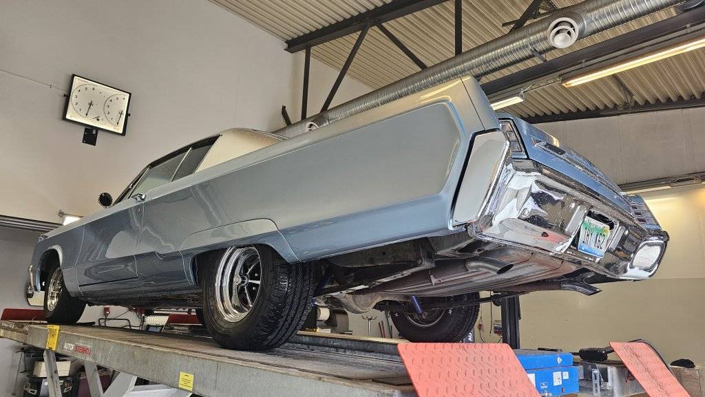

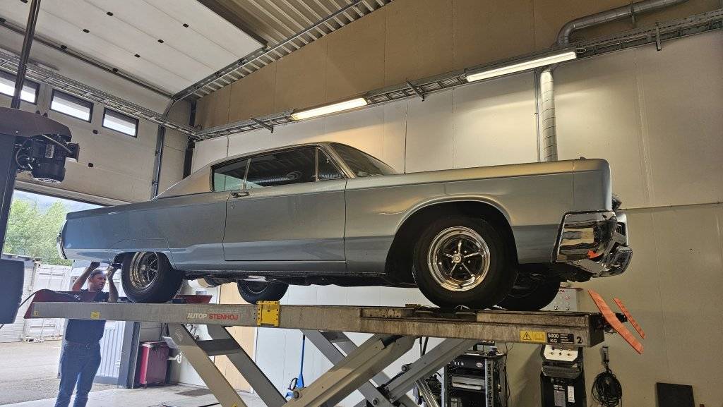

For those of you who have C bodies with a bit more than stock power, what setup do you have?
Did you beef up the stock 383 or 440, build a stroker or use an injection kit like Holly Sniper?
The stock 383 2bbl will probably need a rebuild at some point down the road and I would do the trans to if so. Might look to get a done engine and trans and rebuild the original later on.
I like the 2,76 rear end tbh due to the comfy rpm at highway speeds so we would probably want a torque monster more than a high HP "musclecar engine". Gas milage counts too, right?
I am pretty sure this big old lady can get decent performance with the right setup. She already has the stance of a musclecar
All experience and input is highly appreciated.
