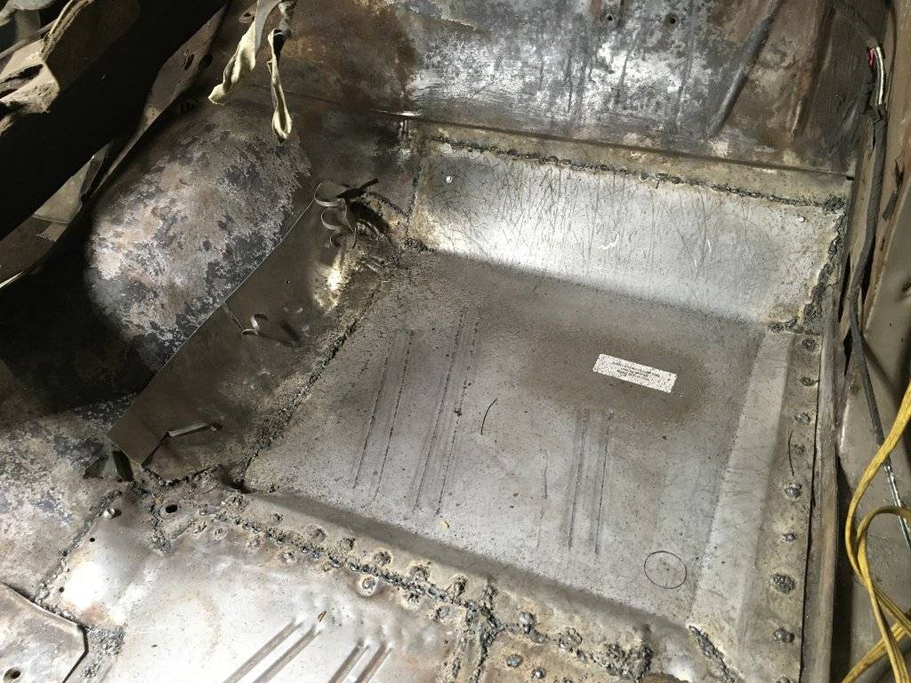

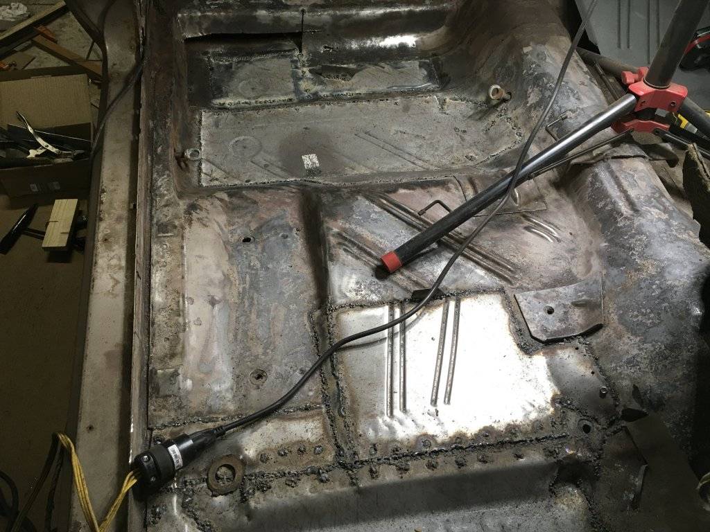

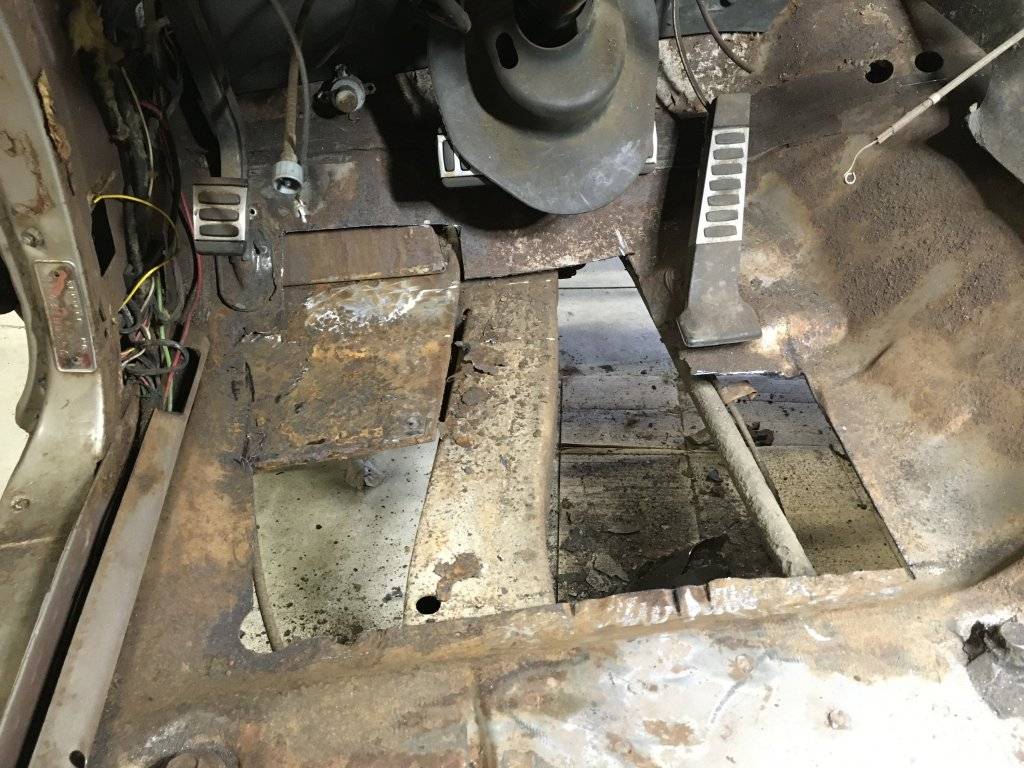

As you can see I’ve spot welded the passenger front pan to the sub frame. But, the trans tunnel is weak and too complex to refabricate for my limited abilities- this is a bucket seat center console car. So I want to bond to the tunnel in the hope it’ll add strength. While there’s less rust on the driver’s side it’s also more complex. The rear driver’s side is clean. Haven’t ground down the welds yet. But, after I do I’ll coat the seams with something. (Panelweld?)
A race car body shop could probably fab a trans tunnel for you. The only "hitch" would be the mounting pad for the floor shifter, though.
I thought of that. But, ensuring the locations of the console mounts (which are still solid) made me decide to try this route
