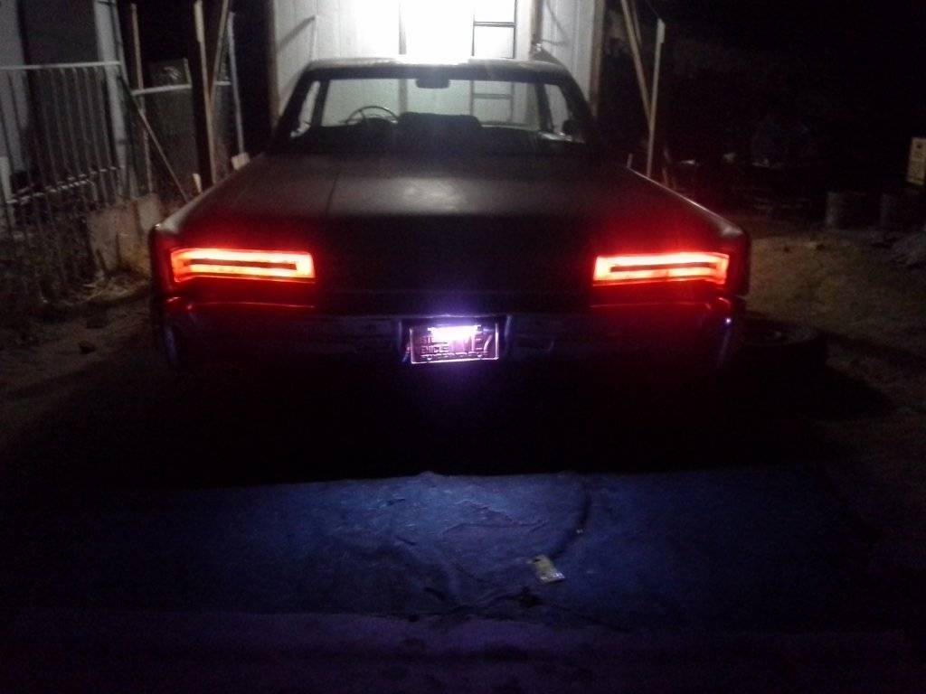

I used red LED tail lights with EXCELLENT results compared to incandescent 1157s. They run for ~$16 @ Sprawlmart. Liked the results so much I added a LED license tag illuminator as well. I'll replace all the lights with LEDs as budget allows, and need dictates. I think Cree makes some nice headlamps for ~ $50. I'll wait for that to come down a bit before spending such dough.....
