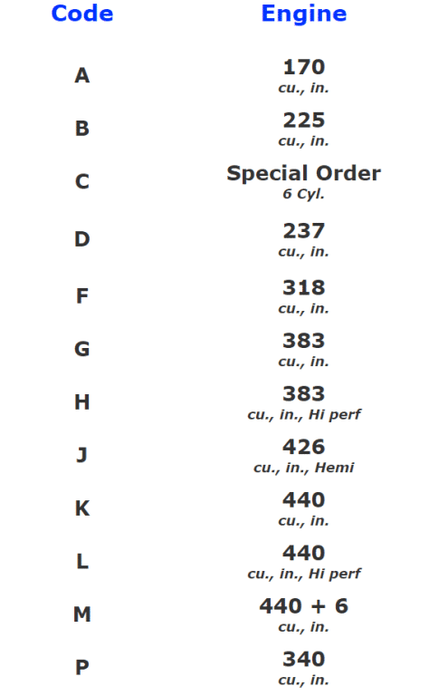

fifth digit of VIN will tell you what it was born with.

source: 1969 Plymouth Vehicle Identification Numbers (vin)
fifth digiit of VIN will tell you what it was born with.
