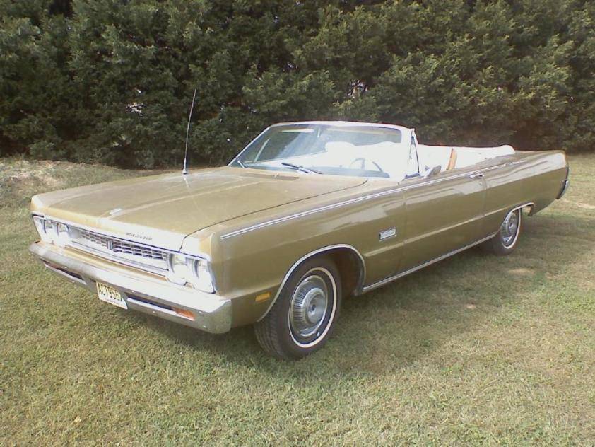

gorgeous 69 fury rag
something is wrong here:
PM43G1F189953 (that is listed as the vin from the company website)
I'll let you guys figure out what is wrong with that.........if there is anything i know abt, it is the vin configuration of a convertible
Don't even think about it. Only an idiot would buy that without laying their own eyeballs on it and you ain't flying out to Washington ..
(Sent using Forum Runner)
The only thing sport fury on this car is the grille... Bet they pulled that number off the pad and its been swapped
I wonder if the fender tag was altered or replaced?
The vin # is for a 71 Fury with a formal top. The dash around the speedometer area has a lot going on. An ugly tach, possibly an oil gauge, a strange item on the gear selector and something else on the right I can't identify. The door panels have some red, white and blue with sport fury stitched on it. The rear tail panel has a Fury emblem on it. I believe that is off a 70's style dash pad. The grille is a standard grille for the Fury I, II and III.
Whats with the defroster vents on the pad? It looks like there are bezels around the outlets
