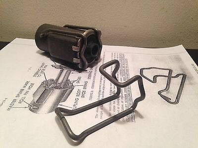

Dec 15, 2014 #3 MrMoparCHP Old Man with a Hat Joined Aug 9, 2013 Messages 6,028 Reaction score 6,214 Location Lompoc, CA Feedback: 1 / 0 / 0 I rebuilt the one on my 67 Barracuda, when I was done I couldn't pry the plate off with a screwdriver. First up kink the tabs half way to about a 45^ angle. Assemble and grease up then with a pair of C-Clamps clamp the cover to the housing. With a drift (flat punch) drive the tabs in. Although I pinched one of the tabs as a result of c-clamps, it is solid. Do it right there is no need for this silly clamp. Alan

Dec 15, 2014 #4 thrashingcows Senior Member Joined May 15, 2012 Messages 3,254 Reaction score 2,624 Location British Columbia Feedback: 0 / 0 / 0 I agree with MrMoparCHP....This is how I do mine as well. But that clip sure does make things a lot easier. ;)

Dec 16, 2014 #5 tallhair Rufus T. Firefly Staff member Joined May 12, 2013 Messages 10,306 Reaction score 4,647 Location Mascoutah, Illinois Feedback: 0 / 0 / 0 I bought two of those clamps and my NZ buddy got two. I'm shipping him his two this week

Dec 16, 2014 #7 tallhair Rufus T. Firefly Staff member Joined May 12, 2013 Messages 10,306 Reaction score 4,647 Location Mascoutah, Illinois Feedback: 0 / 0 / 0 Theses are for 3" couplers
Dec 30, 2014 #8 C Body Bob Old Man with a Hat Joined Apr 8, 2012 Messages 12,037 Reaction score 18,957 Location Youngsville, NC Feedback: 24 / 0 / 0 Drill a hole in the housing & install a zerk fitting
